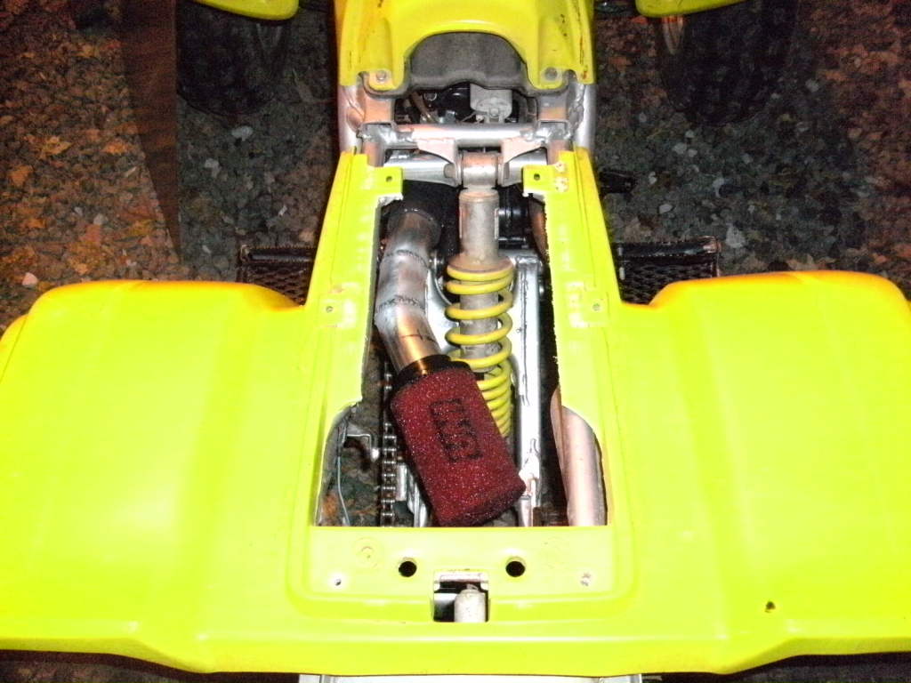

hell you can make your own for less than that . and it will work/look great . I don't even run a airbox , just a pod filter with a outerwears and a 4" velocity stack . Plenty of snap , crackle and pop ..... Just make sure you rejet or it goes snap crackle pop , BOOM!!!
You mean ^^^^^^ that one? I did that because I was going with an OKO 30mm carb with a 2 1/8" inlet and wanted a pipe that went directly to that without having a step down right in front of the carburetor.
