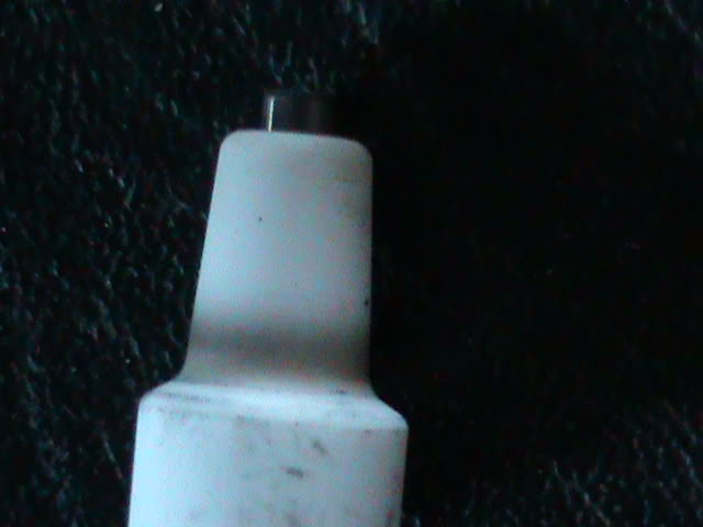

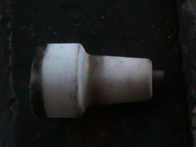

Ken Oconnor ported motor
+3 stroker
lightened flywheel
v force reeds
factory 7 air box, no lid, uni filter
F 7 pipe
35 mm Keihin pwk
160 main jet
50 pilot
needle on the 3rd clip
air screw 1 1/2 turns out
sucker broke on me but these are all the same plug, just wanted to get a couple different views .
looks darker than with the 7 in it (as expected). you could try a 158 or 155 in it when it gets warmer again
that looks pretty close,
if it were me, i'd bump the main up one size and see how it runs, if good, leave it
that'll cover your ass for temp swings
You've not a nice mocha colored ring at the base all the way around just like you want
You can bump it for extra insurance as Awk suggested but you're ABOUT where you need to be so don't go crazy from there!
Thanks guys, I'll try going up a size on the main , I'd rather be safe then sorry. I'm just learning and don't wanna fry my new motor . Again, I appreciate y'alls feedback !
