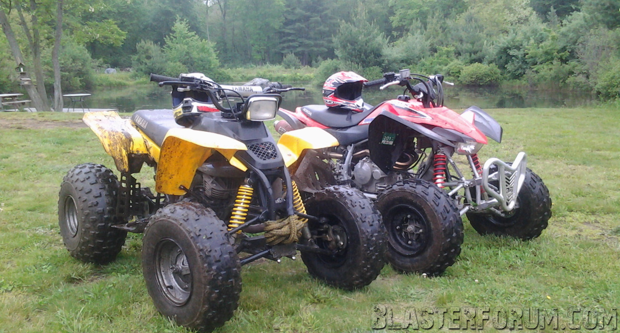

    My little old blaster was in the back of my truck on a bumpy ride and a spare battery must have gotten wedged under the quad because it welded one of the batt terminals to the bottom of the frame and broke off, the quad was in need of a new top end, but now it wont start at all. I don't ride this thing much at all but would like to fix it asap, was doing the top end next week...Is there anything I should just order automatically in anyone's opinion I am sure whatever there is for ignition must be fried lol??

    Going to hook up the spark tester tonight... fingers crossed

    CDI box if anything, no way to test it except swap known good one in, or order new/used one from here or ebay

    Hooked up the spark tester between the plug and the wire.. light came on perfectly as id expect it to. would it still fire like that if cdi was fried?
