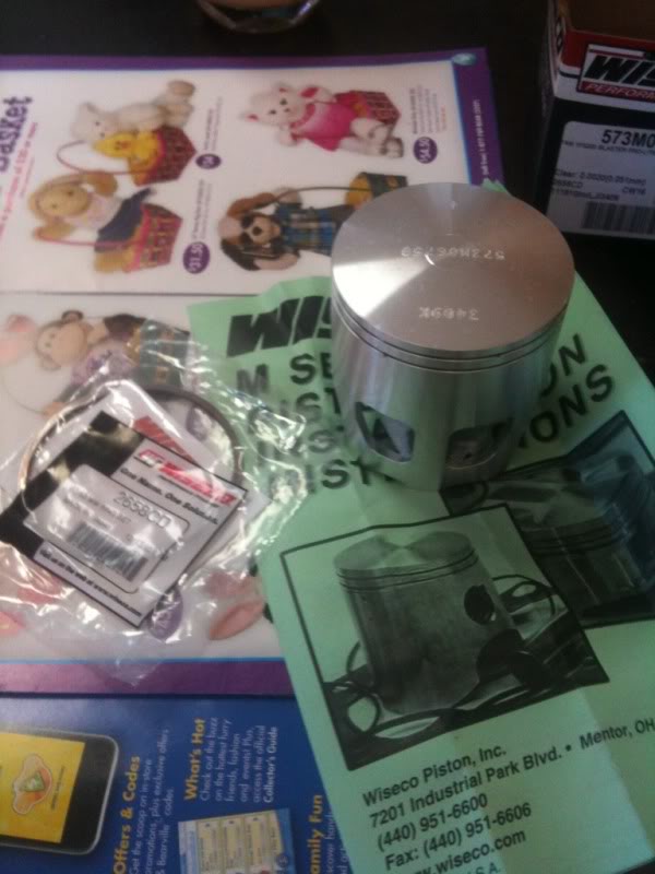

Picked up a brand new in box Wiseco 67.5 piston last night for $70.... Cheapest i could find with shipping online was about $100... in store its $140.... so saved a bit..
Toronto ontario canada....
heres a pic of my new wiseco..
