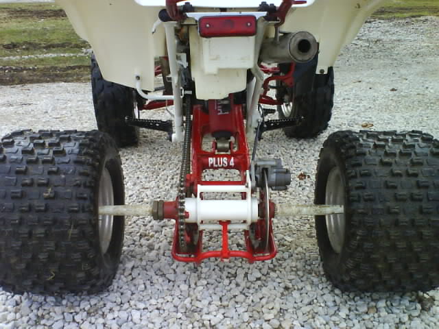

Hi, cool site. I've been building my '88 blaster and would like to know if there is a list of parts that interchange from banshee, warrior ect. I know about the banshee front shocks and the 400ex rear shock, there on thier way. I would like to know if the rear hubs will fit my stock axle? Will the axle out of the others fit my swingarm? Front hubs and brakes fit? stuff like that. Thanx
Thanx for the info, I have the shocks on the way. I have a complete rear brake setup from a raptor and I seen on here that a guy made a bracket to make the caliper fit I might try that today.
trx450r rear shock will work but u have to drill bolt hole to about 1/2 on bottom and get the top eye insert bored a li over on the inside diameter so ur bolt will fit through it.

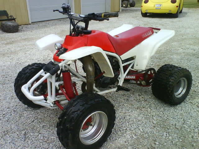

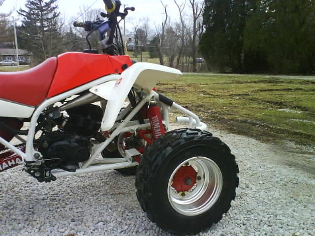

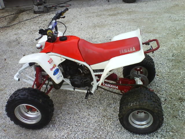

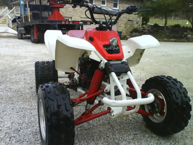

brakes arnt fun. haha post up some pics tho show us yur progress.
She's came a long way​
