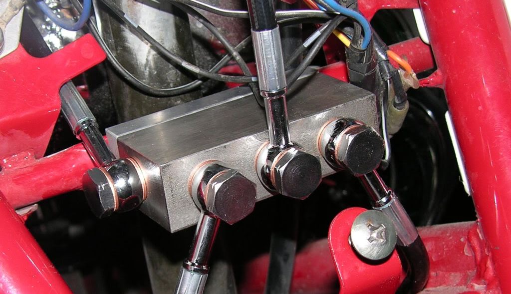

I bought a banjo bolt for 2 lines, a long brake line, a second caliper for the rear and I'm making a mount for the 2 rear calipers. If the master will drive 3 calipers I'll have all wheel brakes on the hand and still have the independent rear brake to set up for turns.
Work in progress.
Work in progress.

How 'bout running all 3 off of 1 master cylinder.
Been working for me for years.
Sent AWK a few of these blocks, if you're interested.

i like that idea better....that way i can still do stoppies on the same lever I:I yes i am definantly interested....how much they go for?
