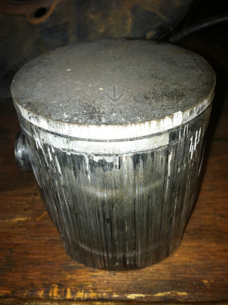

I just pulled exhaust off nd saw the piston has scratches
Did they look like this?
Intake or exhaust side? and x2 on the pics, they help us help you.. If minor scratches on intake side than most likely a bad/dirty air filter/ loose intake boot with debris getting sucked in.. Lots of pple don't realize how important keeping your air filter clean is.

Sorry to inform you but that is not very promising!
You need to perform a leak test and then remove the head and cylinder.
There are signs that the piston has deposited some aluminium onto the bore.
The cylinder may not be too badly scored and may clean up with a hone, but it fear you may need a new piston.
It may clean up, but if would not be using it as the ring lands may pinch the rings.
The scratches aren't rough
When it comes to a scuffed piston, that's about as bad as it gets. The only thing that could be worse is if there were large pieces broken off the skirt. From your info that you ran it out of oil, the crank bearings and rod have to be toast. You are in for a complete motor rebuild. When you get that piston out, you are going to see that it looks like this.
