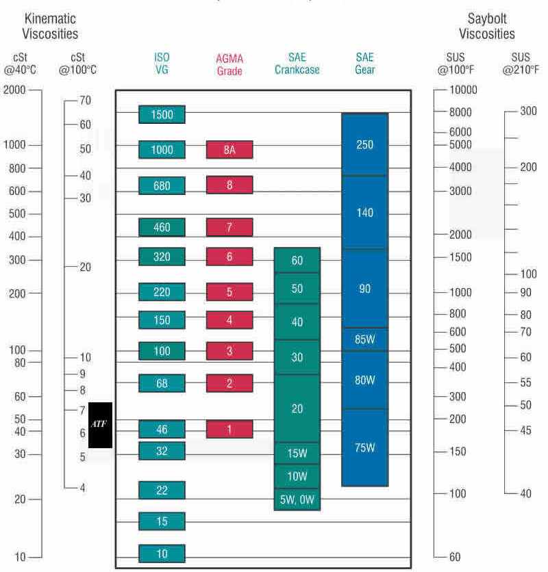

Book calls for 10w30 motor oil, but here are you choices and info:
ATF, thin viscosity, best for the clutch and cold weather
10w30 motor oil, book recommended but watch for "energy saving"
special motorcycle 2 stroke gearbox oil, probably you best choice.
15w40 diesel oil, good choice for warm weather and hard use.
Gear oils, will work, be careful of too much viscosity except in hot weather
Here is an oil viscosity interchange chart:
