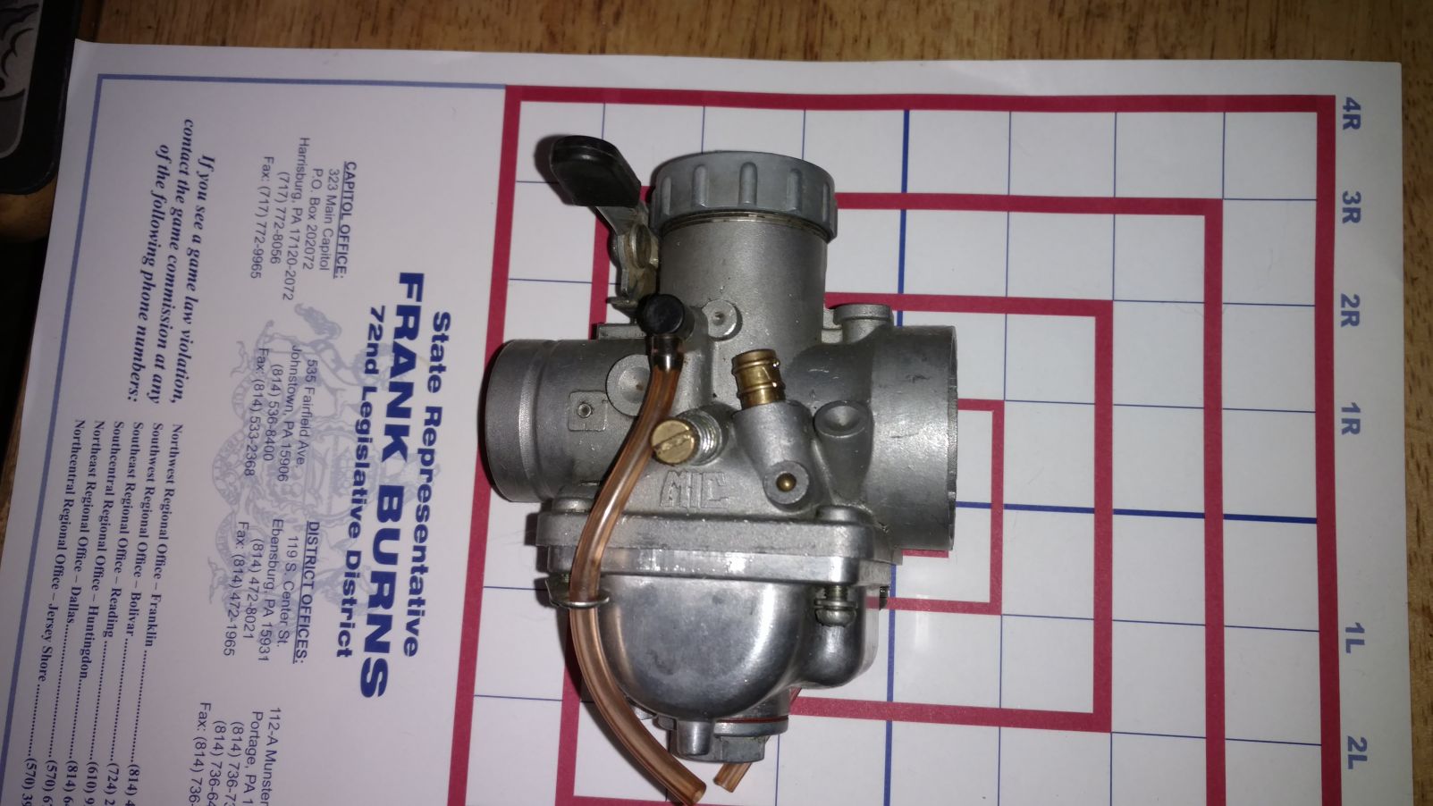

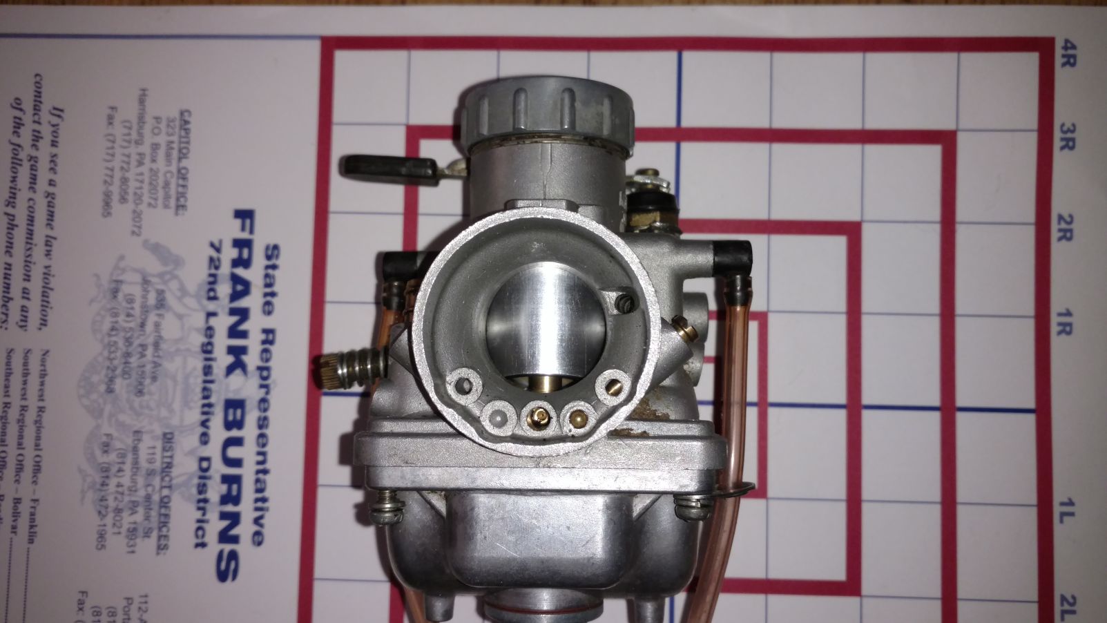

30mm Mikuni,
$65 to your door, PayPal only as friends/family or add 3% to cover the fees
supposedly came off a blaster, not sure what jets are in it ?
I took it on a trade for parts and never used it.
fits in the stock intake boot. 3rd pic is in a 26mm pro design boot
has bowl drain nut for easy jetting changes
you'll need this cable to make it work with the thumb throttle........
http://www.ebay.com/itm/Motion-Pro-...ash=item3616420e1e:g:KzYAAOSw3utY79i~&vxp=mtr
