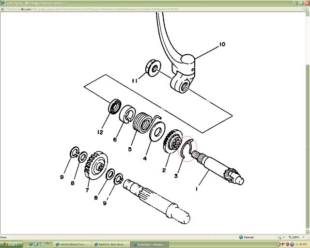

ok well my kickstart wasnt doing nething so i took the clutch cover off to reveal that the spring was broke in two spots and the clip (circled in pic) was gone. i found the remnants in the bottom of my case. when the kickstart was on my bike it had like a half inch of play in and out. would that clip missing on the inside be the culprit for that?
probably if every thing else is there. it was probably a combination of the two.The broken spring and missing clip were probably just leaving a lot of room for play.
