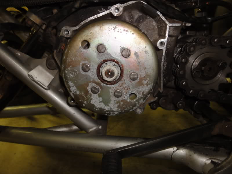

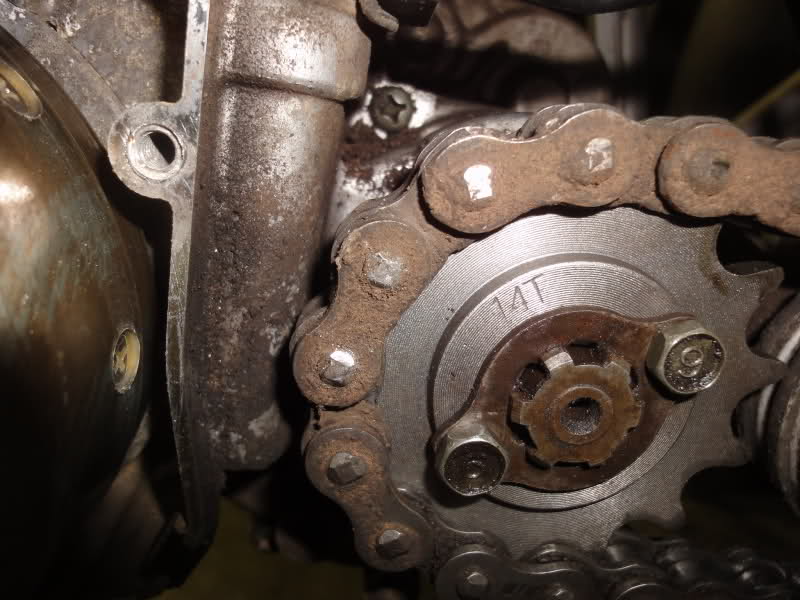

Thanks for the help, I got it on. Had to use a little penetrating oil to break it loose. Here are some pics.
I have a little corrosion on the stater, that normal?
