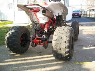

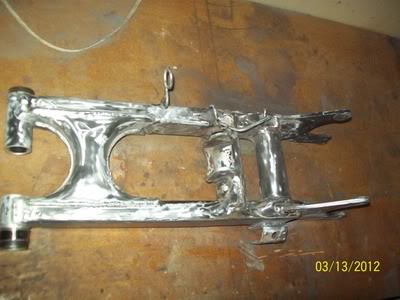

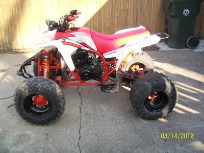

Re: extended swingarm "now complete"

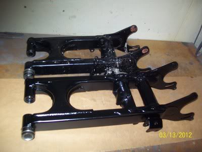

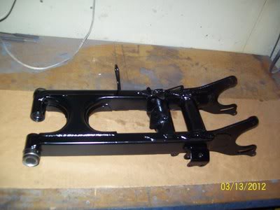

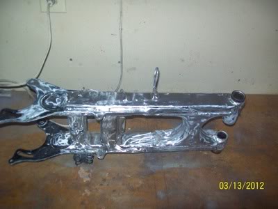

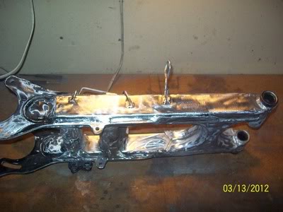

A few days of design and planning and another to complete the task. Custom formed .120 molly plate into 2 .978 x 1.758 x 7.00 tubes that where seem welded. Cut the swingarm legs at the halfway point of the original shock tube mount. Moved the shock tube mount back 3/4" and then press fit the molly tubes in. Then I cut a second swingarm 3 inches infront of the shock tube,removed all the shock mount material from the tube and then press fit that onto the first swingarm. There is 8 3/8 holes that where plug filled to help aid in flexing,and only 1 seem weld per side. All welds where
x-rayed and anything showing possible issues where ground out and rewelded.
Finally all welds where tranisioned and smooth.Its exactly +3 dont let the pictures fool you.
Few pics of the final product,
Turned out nice man
Thanks man, alot of work so far, but the outcome is well worth it.

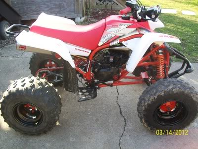

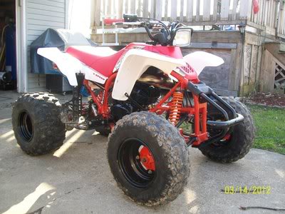

Got the bearing kit installed and its all assembled. Still pulls the front up
pretty easy, but there is more control over that. Still working on front shocks
for it, and getting the flywheel lighten'd up. Pics of progress.
