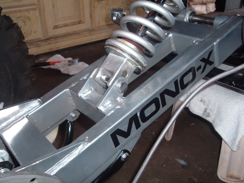

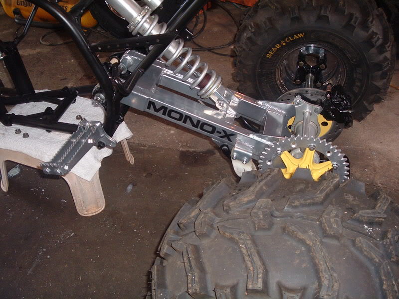

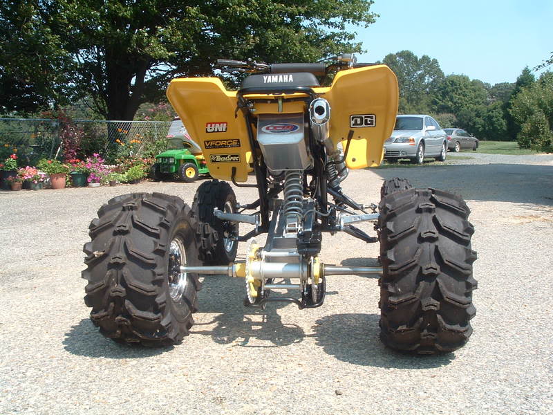

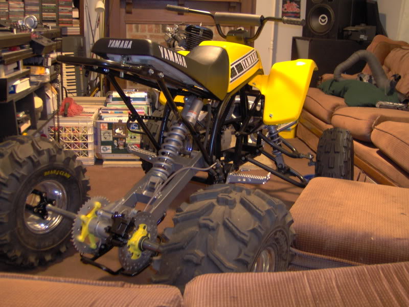

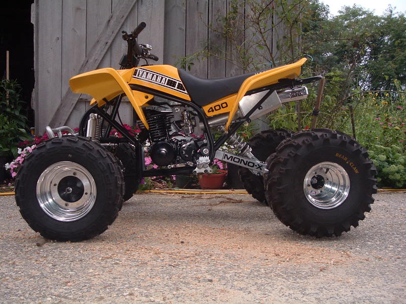

Heres some pics of mine:
agreed, it should be, putting the shock at a different angle is going to do all sorts to the suspension geometry, im my mind there is a risk of bending the shock rod instead of compressing if its lying too flat, not to mention the travel which is surely compromised.
