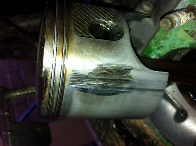

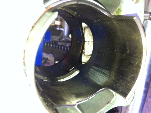

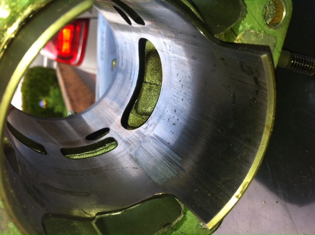

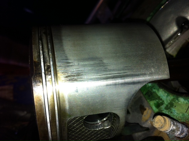

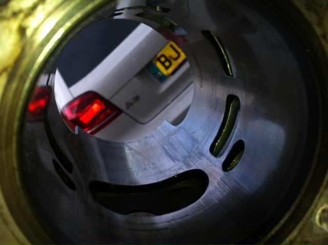

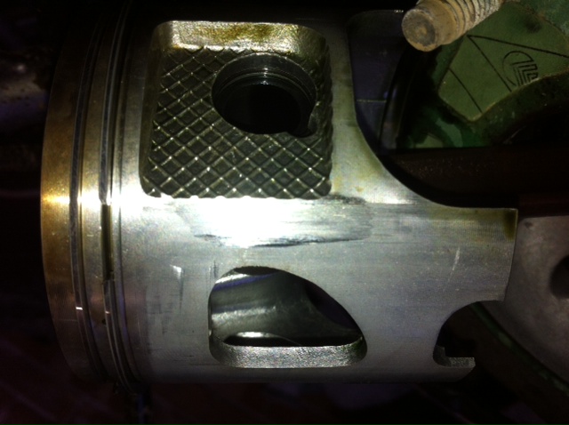

engine damage pics
That piston shows symptoms of lack of correct warm up pinch. It looks like the scuffing is pretty well 4 cornered.
I notice the green base gasket, could that beggar have been leaky.
well it had been run on the 25 pilot so i suppose it would have warmed up way to quick, also the metal head gasket had gone a funny green colour in one place?
the piston is a std 72mm forged vito's, what size do i need now?
