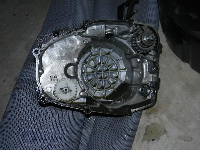

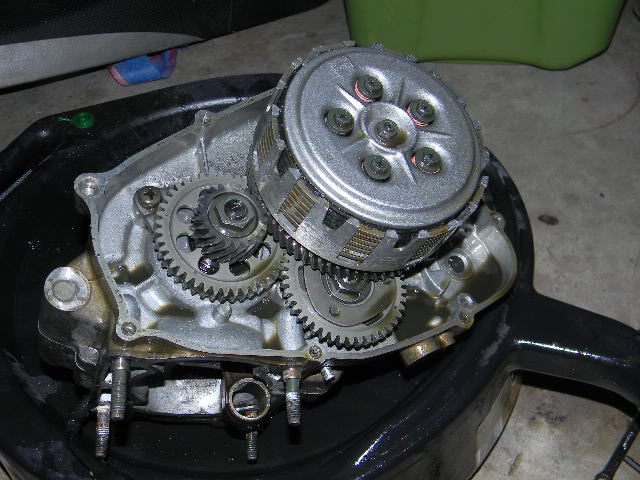

Y yo_boss New Member Apr 3, 2012 23 0 0 Apr 5, 2012 #1 I'm looking into rebuilding or buying a new stock engine for my 2005 Yamaha Blaster can we tell anything by my pictures??
Y yo_boss New Member Apr 3, 2012 23 0 0 Apr 5, 2012 #2 now the wheel that on opposite side of the cranks is rusted is that natural or it needs to be cleaned or replaced??
slickerthanyou New Member Dec 23, 2009 7,615 140 0 Apr 5, 2012 #3 yo_boss said: now the wheel that on opposite side of the cranks is rusted is that natural or it needs to be cleaned or replaced?? Click to expand... The flywheel?? Yes should not be rusty! Everything else look as it should to me.

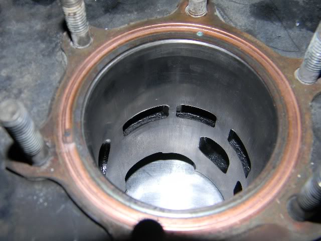

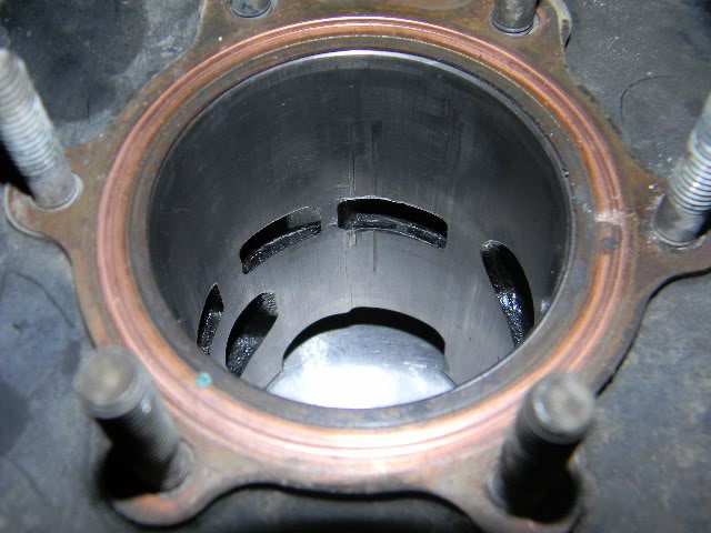

B blasterdemon7 I'm not winning. Nov 19, 2009 13,642 251 125 53 Delaware Apr 5, 2012 #4 I don't know if it's just me but that jug looks a little jacked up under that one port. Kinda looks like a smal chunk out of the wall.
B blasterdemon7 I'm not winning. Nov 19, 2009 13,642 251 125 53 Delaware Apr 5, 2012 #5 I think I see a crack in the sleeve to????????
slickerthanyou New Member Dec 23, 2009 7,615 140 0 Apr 5, 2012 #6 blasterdemon7 said: I think I see a crack in the sleeve to???????? Click to expand... I did see that but just thought it was aluminum scuffing maybe a crack!
B blasterdemon7 I'm not winning. Nov 19, 2009 13,642 251 125 53 Delaware Apr 5, 2012 #7 To me, it looks like a crack from the bottom left of that one port going all the way down. I seen it when I zoomed in on the pic.
yamaha28 Member Apr 8, 2011 2,266 32 84 Apr 5, 2012 #8 I think BD7 is on to something there, check that cylinder for scratches!
cruelsoul New Member May 8, 2011 464 5 0 Portage,Pennsylvania Apr 5, 2012 #9 def looks like a small crack
L Larry's Shee Active Member Technician May 23, 2009 9,271 1,057 149 Ortskaville, MI Apr 6, 2012 #10 I think the cylinder should be bored at least. But as said, in second pic the "scratch" that goes from the bottom of the transfer port to the transfer tunnel. What did the piston look like? Did you do this or did you get it this way?
