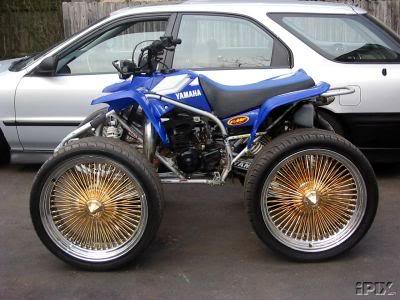

Uhhhhhhh is it bad if I don't know what to say besides I hope, very dearly, that you are kidding. and thank you AWK for not making post the well known Warrior with chrome spinners pic I have as my background that I found on Google. A Blaster fits the topic better anyway. lol
thats a nasty ass asphalt dragger !!!!!!!!!!!!!!!!!!

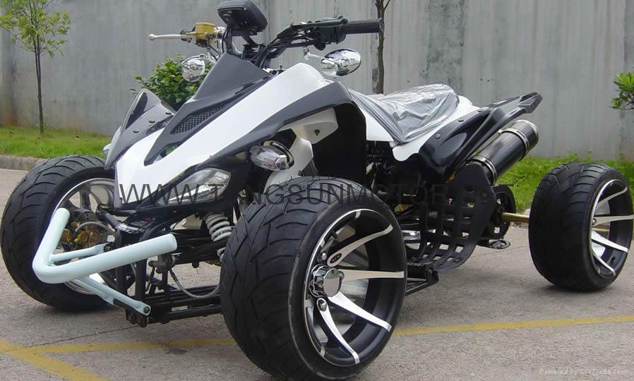

The on road guys purchase rims special made for quads and then put on road atv tires on them...

Those wheels like in the second link are what the on-road guys get I believe. Probably not the camo ones but they're made for ATV's and have regular tire sizes.
