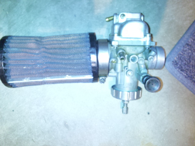

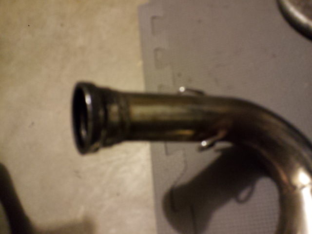

SO tmw im going to pick up a Toomey T1 exhaust/pipe, a stock carb, and Tors Removal kit from local guy for $100! QUestion is adding the Toomey to my stock Blaster do I need to rejet? and to what?
Sure do need to re jet, post up all your mods, temp and elevation and some kind person will attempt a ball park figure on where to start the plug chop.
Ok so the carb he gave me already had 320 jet so I should be ok? Everything on my blaster is stock. I have the toomey pipe T1 exhaust, also the carb he gave me has a K&n filter on it
The parts are a little spendy and their response time may be a little slow but the quality is top notch I:I Blaster Pipe Parts
Edit: I would run an air box at the dunes or at least get the proper oil for that filter and run an outerwear.
