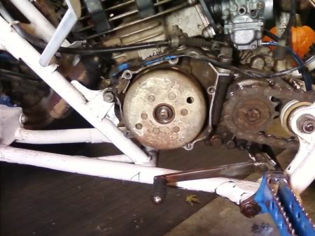

I took all the tension off of the cable already. Is it supposed to slide off once the center nut is removed? It doesn't seem to budge even after tapping it with a rubber mallet. I must be doing something wrong...:-/
the clutch is on the other side of the motor you have to take off the right side (if your on the bike) cover an the clutch is in there with the oil pump
Yea I realize that now. I just figured since the shift lever and clutch cable are on that side that the clutch would be too. I'm guessing that is the stator in the picture then, right?
yep....
