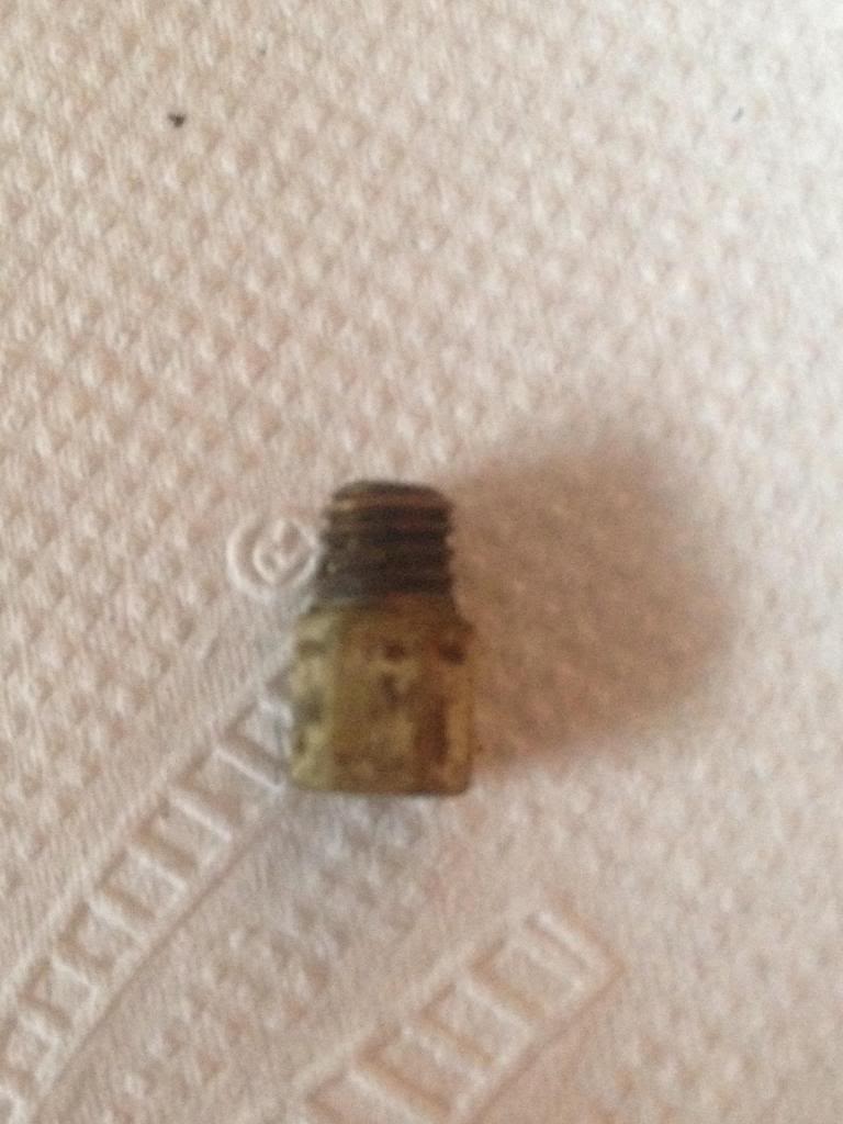

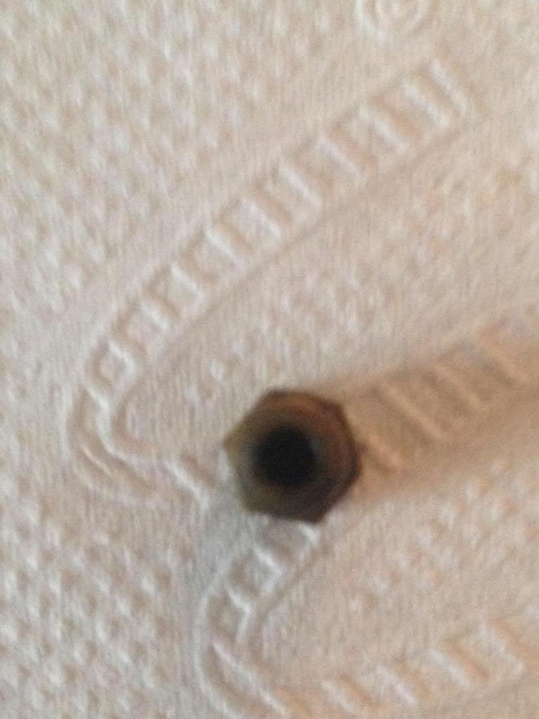

Well in an earlier post you said you cleaned the carb good. By the looks of that jet I doubt it is clean.

So I tore apart the other carb I had and am looking at the jets, I have no idea how to tell what they are. I am tearing into the other one as soon as I'm done this. Sorry for the bad pics my iphone is terrible.

Now I can see threw it lol, it was all clogged up.
