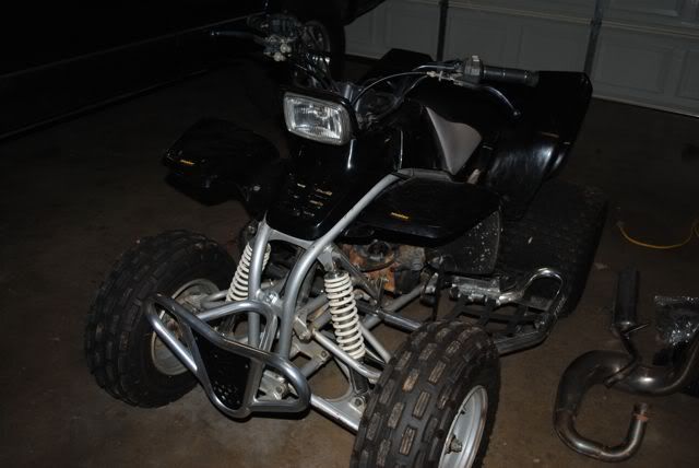

I promised some pics and you guys seem to live on them so I thought I'd better get it done.
It's really nasty here right now but it occurred to me that I copied the craigslist pics when it was for sale.
http://i1233.photobucket.com/albums/ff387/TonyHarrell/DSC_0004.jpg
http://i1233.photobucket.com/albums/ff387/TonyHarrell/DSC_0002.jpg
http://i1233.photobucket.com/albums/ff387/TonyHarrell/DSC_0005.jpg
Not bad for $275 huh?
Brought it home and got the aluminum off the cylinder walls from the seized piston.
Put a new piston in it and fired it up.
edit: I measured the bore after cleaning it up and it's a really tight 2nd over.
It appeared to run lean when it seized.
After some research on here I bought new jets and settled on the first one we put in, a 300 main.
I thought it would blubber but it was pretty crisp.
Awesome Deal!!! Looks Good.
