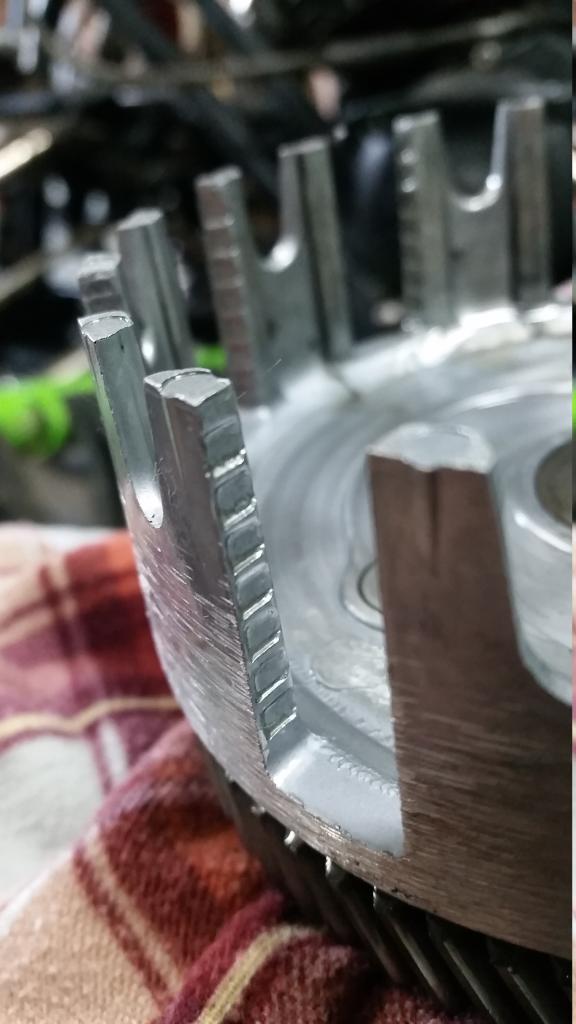

take off the cover and pull the lever. do the plates separate? check the basket for grooves and see if it needs to be filed/replaced.
this is what mine looked like, so it was replaced
The basket had already been filed n there is fresh fluid in it. I'm thinking it something to do with them plates or cable though so I will check them. Thanks for the help. Will report back
