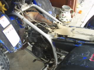

Here are some of the picture's of the project I started, I still have to prime the frame and the parts with macropoxy 646 I was going to do a automotive bare metal primer but I think i have around a 3 to 4mil anchor profile witch might be too high for a automotive primer. Ill post more picture's as I get farther into the project. Feel free to ask any questions.

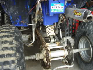

"brandoz28" I just got the quad the other day, the pipe that came with it was a power core 2, I am running behind schedule, all the parts were stuck like chuck, they took a grip of blows from a sludge and a 2x4 and I could never get the carrier off so I just left it be. Over all I am pretty happy on how everything is turning out, By the way things are going right now I am guessing I will have this all wrapped up by Monday. My girlfriends son is really happy tho and she likes the way things are starting too look.

Ah lol yeah man I need too get a new one! I was thinking FMF or DG what would be good for it?
FMF is a decent trail pipe really, DG's are basically a chrome stocker. there is a pipe review thread on here in one of the engine sections i believe....that's a pretty heated subject around here lol

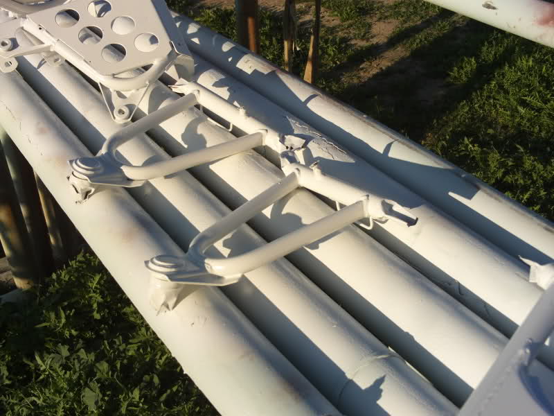

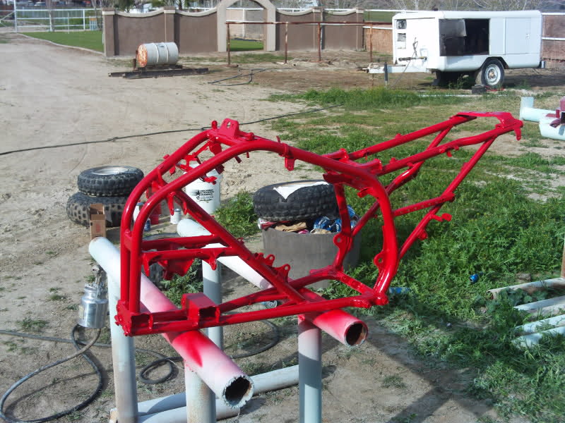

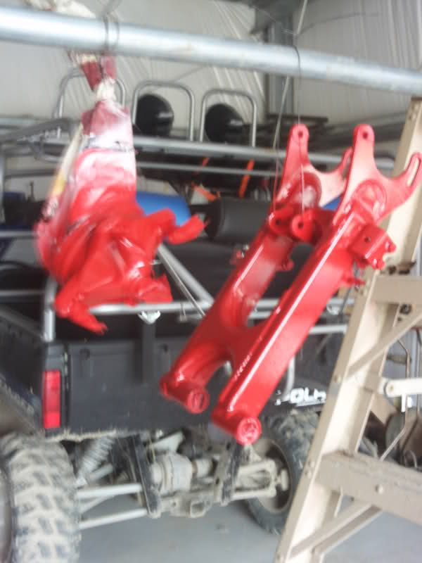

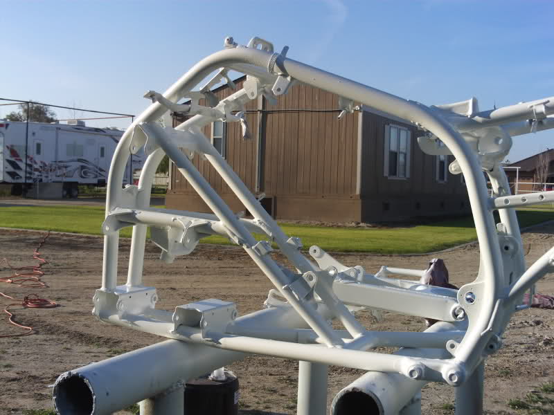

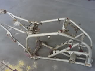

OK here we go, I got to go out to my ranch today and finally do the macropoxy 646 primer I put about 8mills wet, 8mills seemed to cover the anchor profile pretty good, Tomorrow I will go back out and do a light prep then shoot the frame candy metallic red the swing arm candy metallic red and the hubs candy metallic red , The upper and lower arms silver the foot rests silver the axle receiver silver and the rims a fresh coat of silver as well. Here are some of the new pictures from today. I will post new one's tomorrow when I do the top coat. Man today was such a good sunny day!! Hopefully 2marro is too when it all counts!!

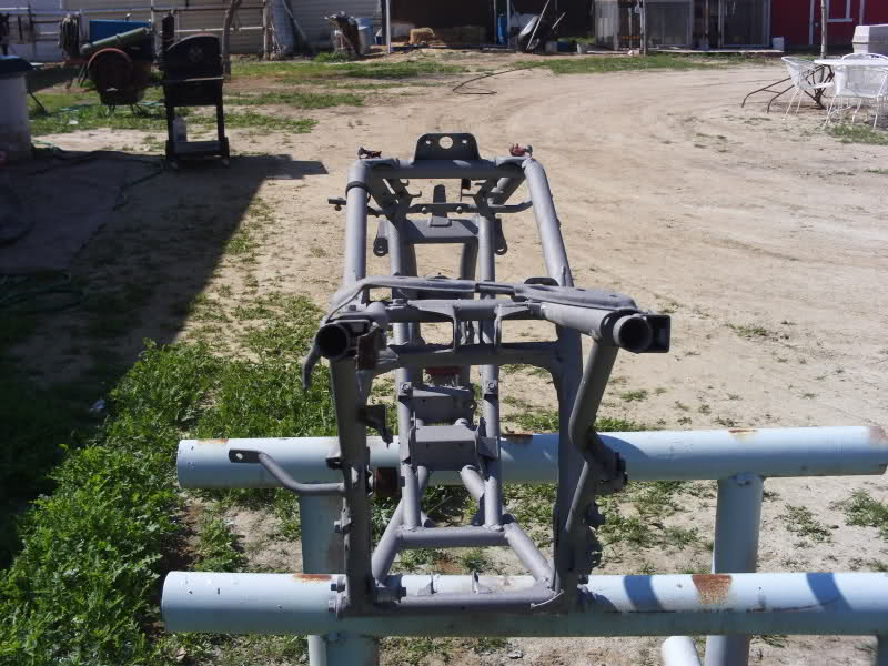

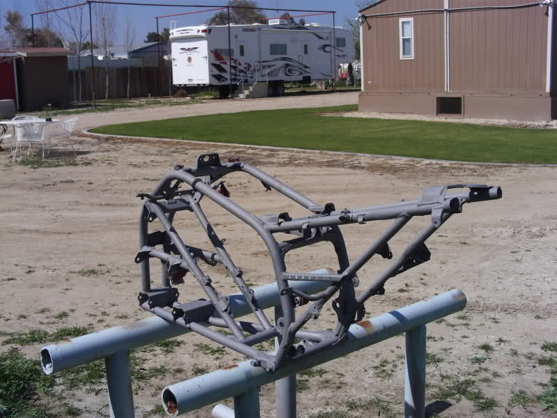

Sandblasted Frame Before The Primer
Different Angle Frame Before The Primer

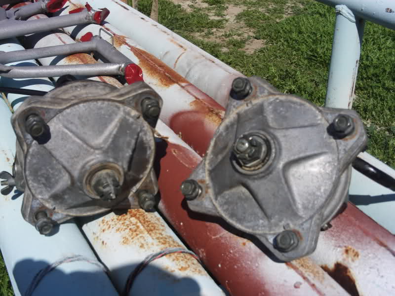

Brake Drum/Front Hubs Before The Primer

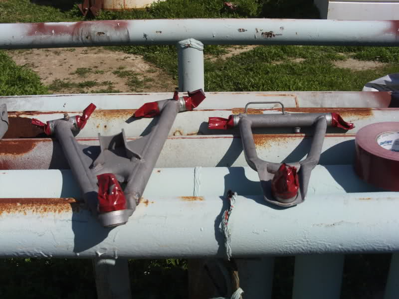

Upper And Lower Arms Before The Primer
A Fresh Coat Of Primer On The Frame

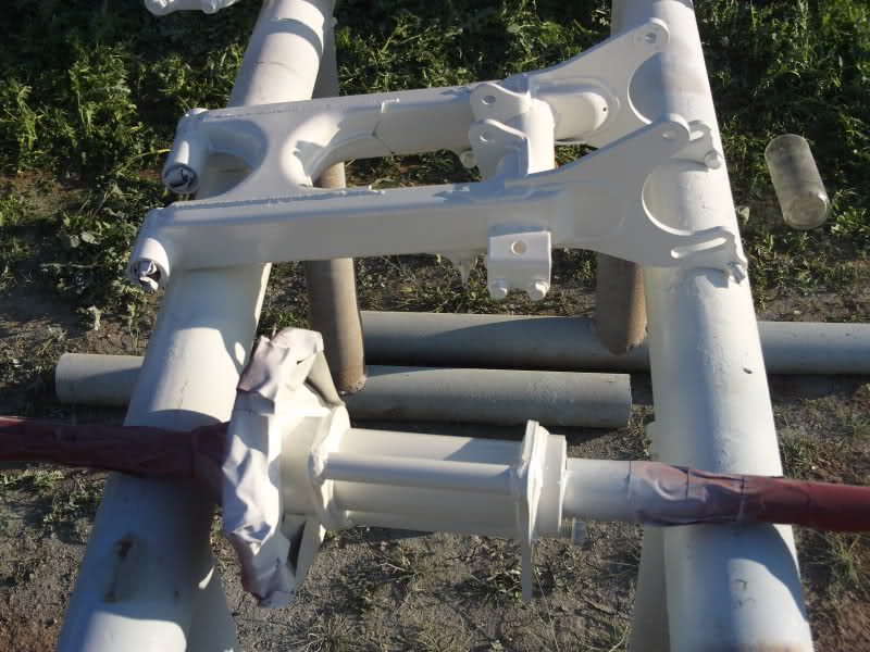

A Fresh Coat Of Primer On The Swing Arm And Axel Carrier

Lower Arms Primed

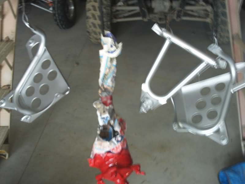

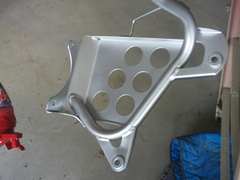

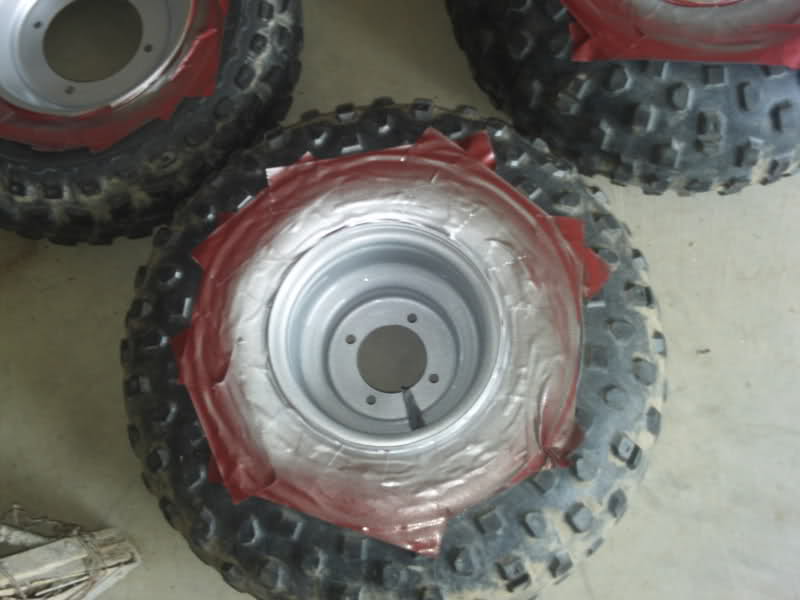

Heres what I got to paint today, Hopefully tomorrow I might be able to start putting everything together.. worst case would be Sunday.
"Charles14" Thank You sir. I used a 375 ingersollrand air compressor to spray the primer and the top coat/red and silver. The primer I used was a industrial primer and the top coat, metallic red and metallic silver were some expensive automotive paints, The black is a industrial epoxy.
