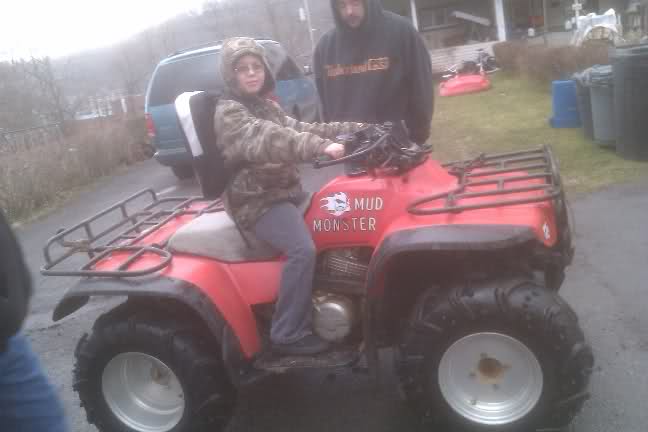

my buddy in the pic(rappy700) with his son on the bike, his dad had me go pic this up for him yesterday evening, supposedly only used on the farm and to drag a few deer, all in virginia, the owners sold the farm and moved back here .............
'91 trx300fw for $1500, fires right up, has a kickstarter too, motor sounds and feels very strong,
although it's geared very low, has a warn winch on it, A/M tires and wheels
the hour meter in the trunk shows 500 sum hours, plastics and racks all in good shape, brakes, lights and everything works so far, had new bearings installed in the rear diff.

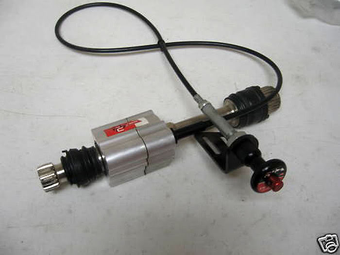

From the factory the honda TRX300 fourtrax's were AWD. Warn did, for a time, make a 4-2-4 disconnect that basically replaced the front drive shaft with a selectable unit.

If there is a warn 424 on it, it'll look like this:

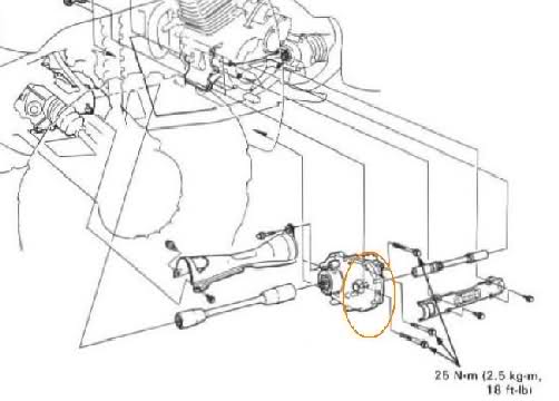

ok, my bad, maybe i meant this cable comes off the transfer case ? not the front differential
in the orange circle...............

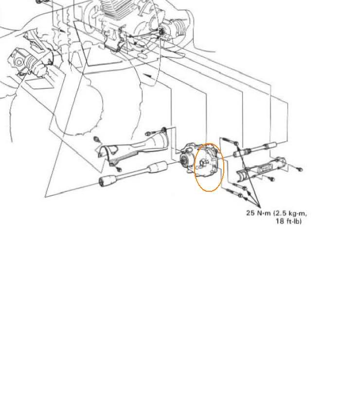

That's the transfer case on the TRX300's and a cable coming off that would probably be a speedometer cable because I'm not seeing any factory cables there.... the speedometer would have been a dealer option and installed by the dealer and wouldn't show up on the parts diagrams.
again good info, no wonder i couldnt see anything in the manual, even the pics don't show a speedo, maybe i have a look on ebay ??
