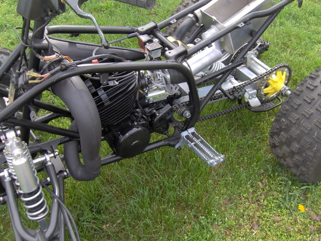

the hardest part of any swap is the pipe, trying to use the pipe designed for that particular engine, yet fitting into the blaster frame
here ya go....yz400 in a blaster
Reactions: Slydog
here ya go....yz400 in a blaster Looks f'in sweet. i am in the the the middle of the same build and would love to pick your brain. like what setup did you use for throttle? your pic answered my air box question but pricy.
Im in the process of doing a yz400 swap into a blaster by chance do you have a picture of the mount you used to bolt the engine in?

As AWK mentioned the pipe is the hardest part. You have to realize it’s custom fabricobbling at it’s finest.
Basically you either have to have a custom pipe made or you have to modify a stock pipe without changing lengths or shape. You have to use a full pie cut if you need to rotate it.
Search member “Best” he cut the pipe and installed a two piece bolt together flange to mount it.
