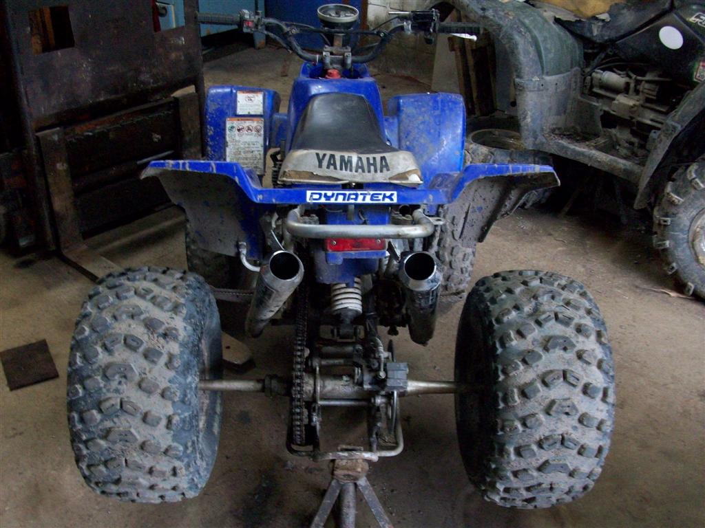

Got the Banshee axle installed. Looks much better. Front spacers should be here in a few days.

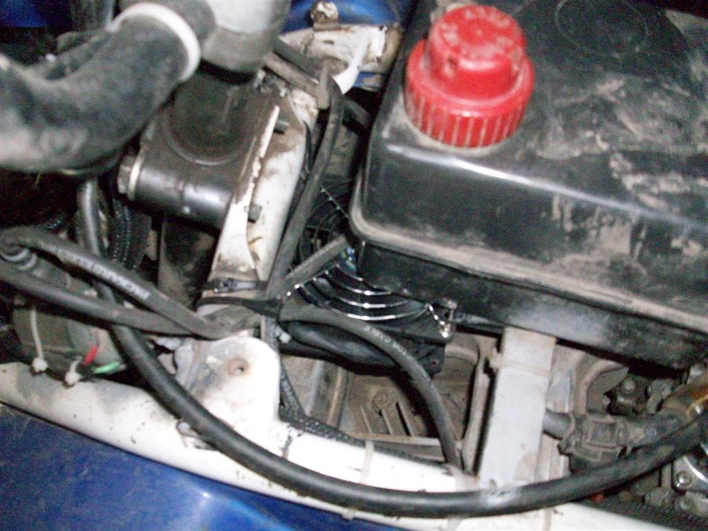

I did not have the quad running until the end of summer in 2010.. So I found out this year that it does not enjoy July weather. I added a small but high power cooling fan. I'll have to see how much it helps this weekend.
Not hatin but I can't imagine that fan doing much. do you have air scoops?
Also running alcohol would end any cooling problems.
