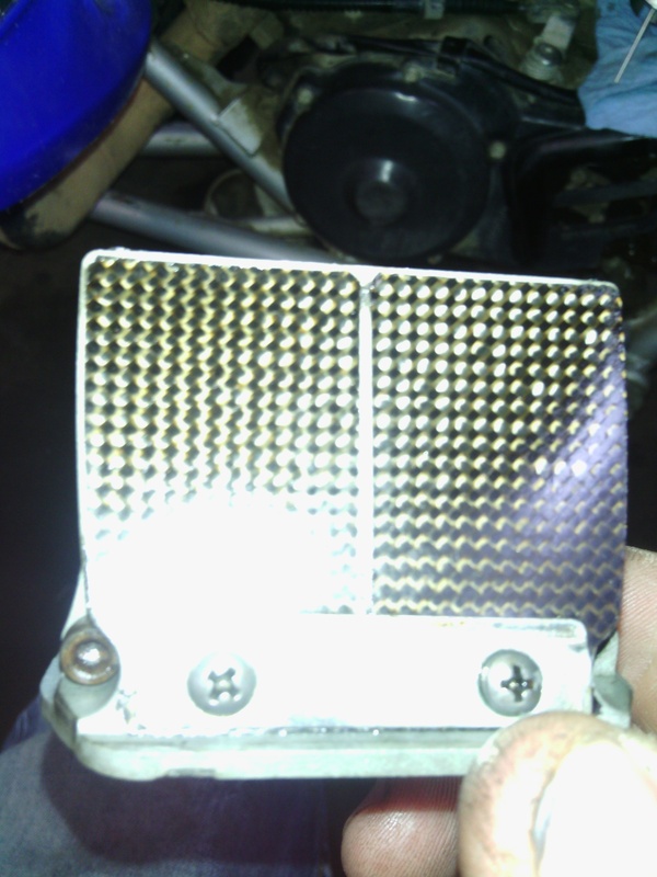

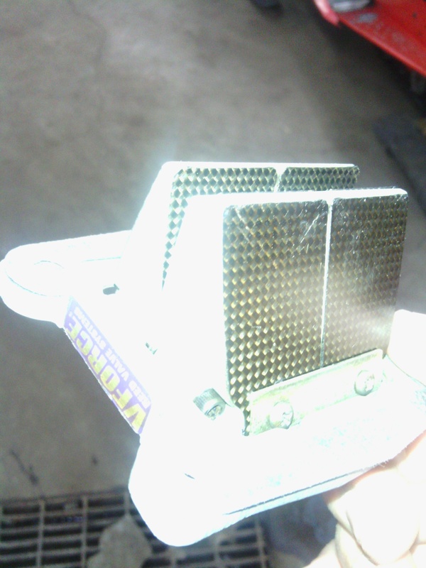

Hi everyone new to the forum...I bought a 01 blaster a few day ago . Started to take it apart and look it over good to see what it needs . The reed pedals are bad and I'm going to put in a new top end while its apart . It has v-force system in it now but I need to know which ones they are . They don't look like 3's or 4's .

those are V-F 2's with the screw retainers.
replacement petals are still available thru the manufactuer.... moto tassanari
http://store.mototassinari.com/index.php/
you may have to call them if they're not listed on the website,
but someone else just reported they do still carry them
That was quick...thanks !! Figured they were older ones . Maybe It will be easier for me to get a stock cage and some good aftermarket reeds pedals

if that is so, they're the only petals I know that fit both, as the stock cages and petals are definately different for blaster and shee
I'd call moto tassanari to be sure
