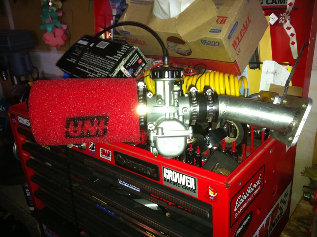

Here's a pic of my banshee set up
most who have tried directly onto the carb, like pictured above, have had jetting nightmares, a 4-6" extension of 2" pvc helps strighten the air out before it hits the carb/jets

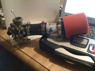

here is what i have 5" long trenga racing tube and a uni pod

my 2¢ unless your running the street or sand, i'd use an air box. One puddle could destroy your motor.
I was thinking tht too... What if i angled it under the seat into the airbox with the straight tubing.... Any diff over just usin the airbox?? Or i was thinking of building a little cage right around the filter?? Any ideas .. I dont really want to mount it to the airbox... I wont be going in mud or puddles just loose dirt...kinda dust..,
eh, i run the pod with about 3" of tubing. does just fine and the jetting isn't screwy at all.
You'd have to damn near submerge your uni for water to get sucked through it . Especially because it's oiled and if you are running an outerwears .
I did run a velocity stack on my blaster intake with my pod filter , but the example I showed you the 2-1 intake for the banshee is the velocity stack in that scenario .This was my blaster set up , it shows the velocity stack and the rubber coupling .
