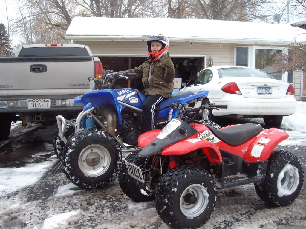

My son had and LT50 it was a 2002, great little machine. It was a very simple machine and easy to work on. I would pick it up. Don't see many youth ATVs and they seem to hold thier value.

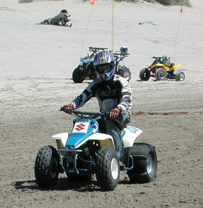

Our old LT80's & the tow quad :) there's a Blaster hidden behind the Scrambler ... there's always a Blaster around somewhere!
