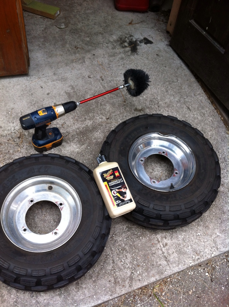

    This thread is going over how to make various things shiny (going for a sticky)
    Plastic (buffing brings shine back)
    http://www.blasterforum.com/plastic-146/plastic-resoration-shinemaster-way-48792/

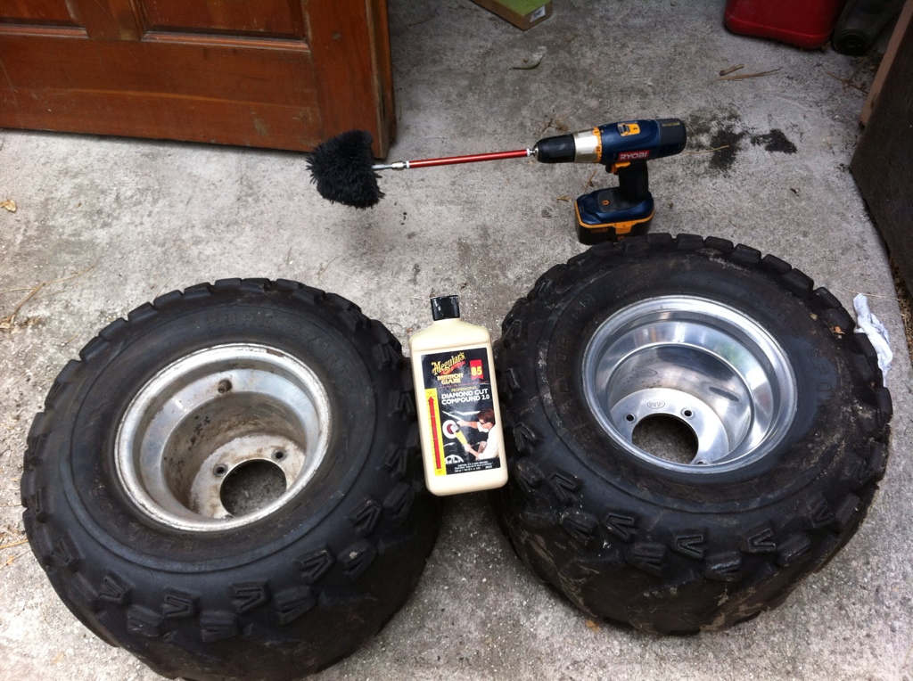

    Wheels
    Meguiars diomand cut compound
    [​IMG]

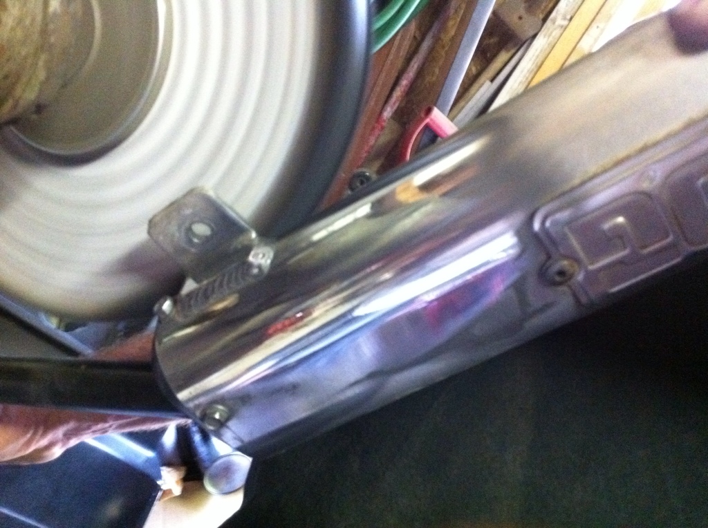

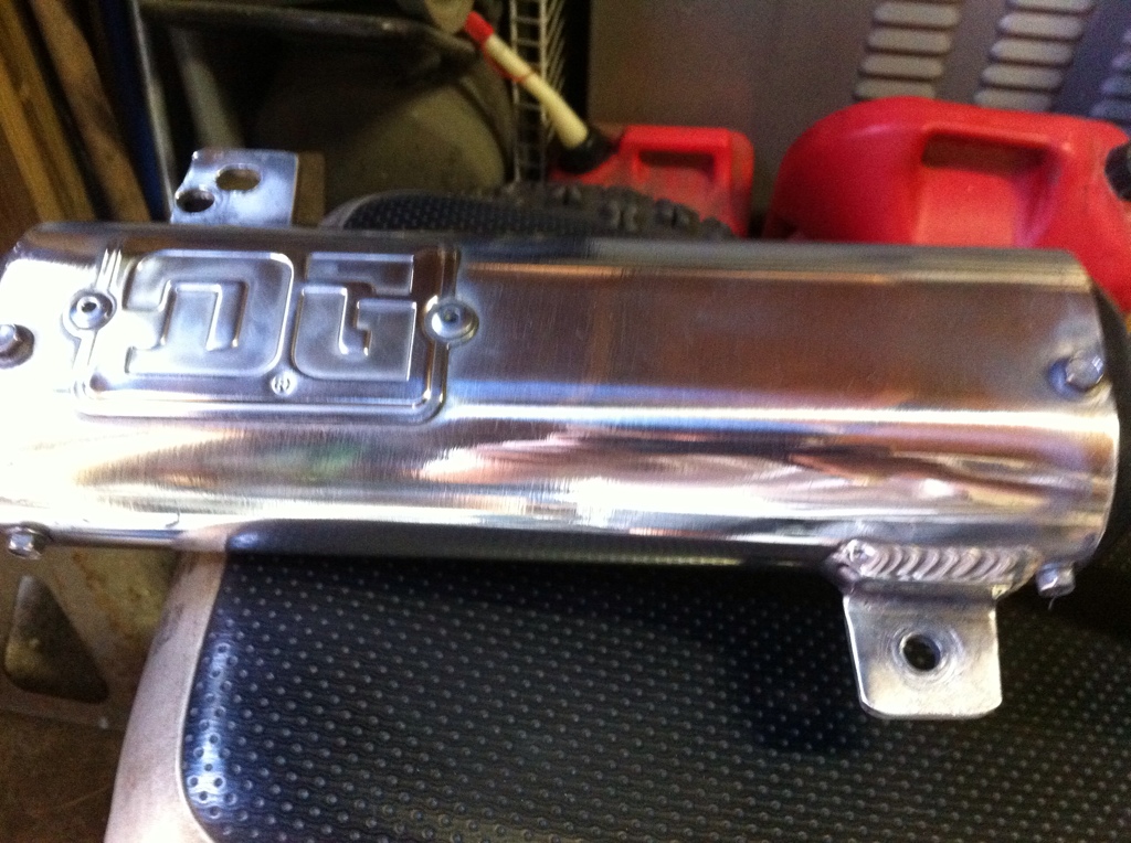

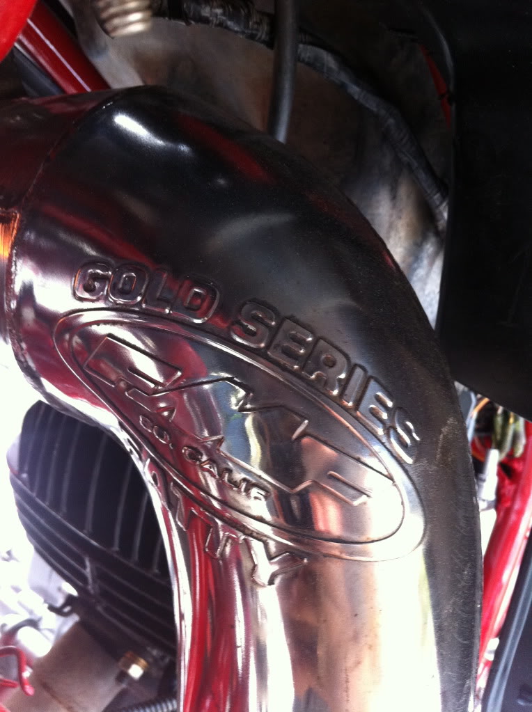

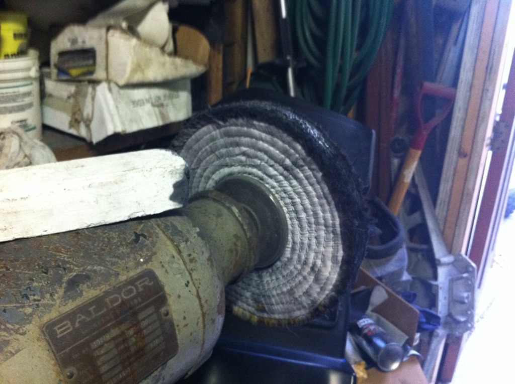

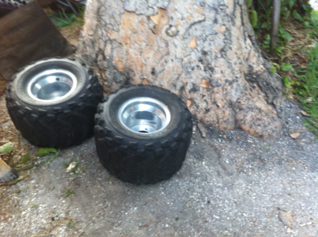

    Any Other aluminum- table grinder with buffer wheel and compound (good for pipes
    [​IMG]
    [​IMG]
    [​IMG]
    [​IMG]
    [​IMG]

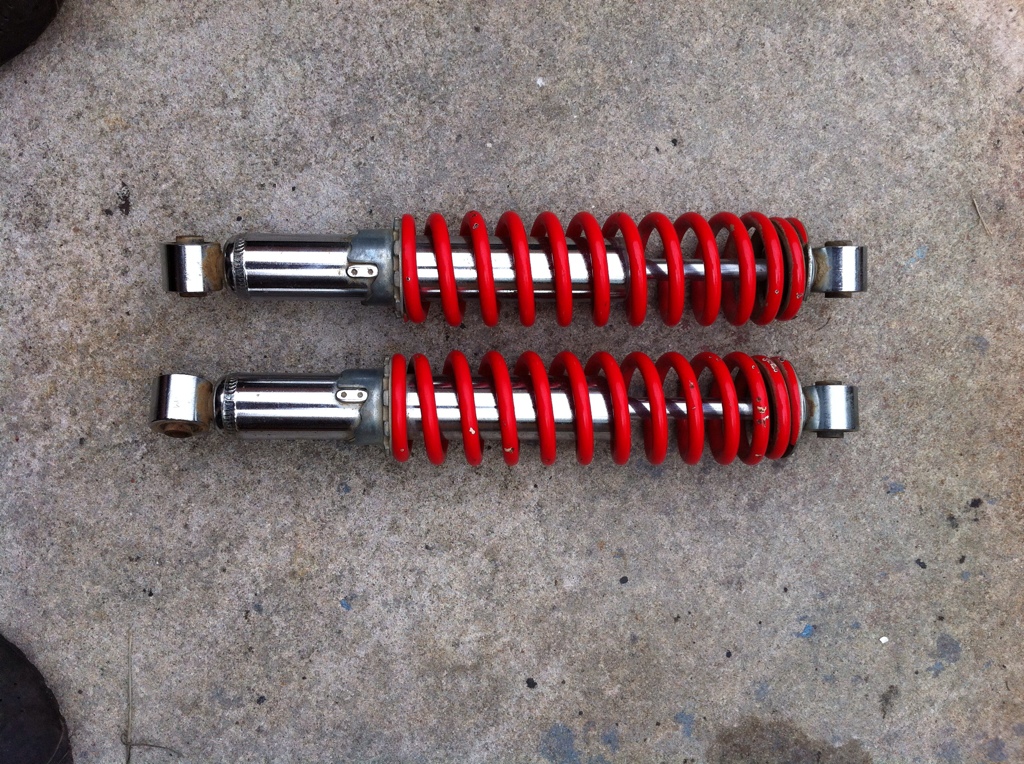

    Shocks- steel wool and elbow grease

    I just finished polishing my wheels yesterday. I used white, red rouge then finished them off with Mothers by hand. It's amazing how much difference and little time and effort can make.

    what kinda buffing compound did you use on the pipe?

    The white block, in the picture of the buffing wheel I don't really know what it is because it's really old

    Did the backs of my wheels today because I got bored, and I flippedy fronts I:I
    Before[​IMG] after
    [​IMG]
    [​IMG]

    Can you use a normal power drill and get same results i want to polish some stuff on my bike but dont wanna do it by hand lol

    Yeah just get the right buffing wheel and compound

    Most of my stuff is done on a bench grinder with a buffing wheel on it or by hand.
