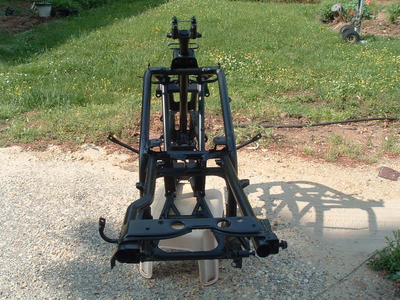

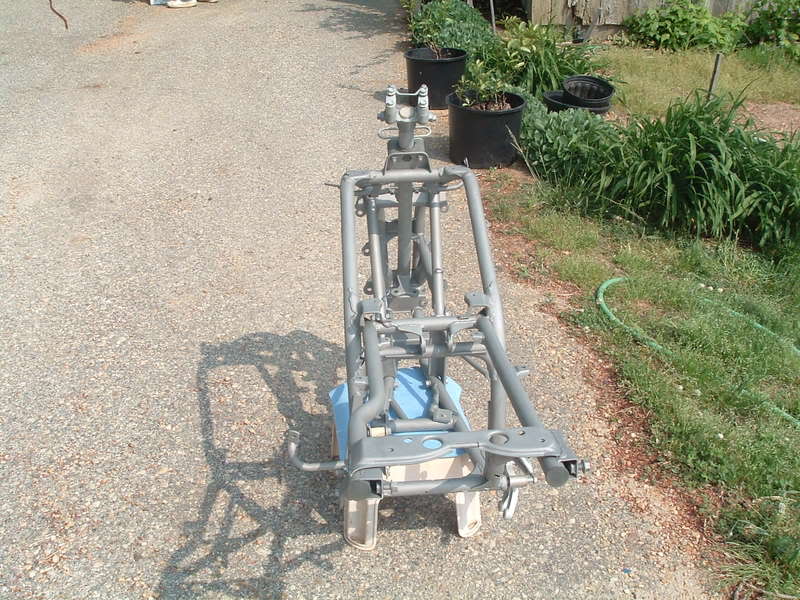

Here's some blaster stuff I did with the ol' siphon blaster.
Good work man!
I always used iron phosphate before I powder coated...but with wet paint you can do a general thinner wipe down after blowing it off with an air nozzle...but yeh...that grease is annoying when you're painting...especially if you touch it after blasting! If you wanna check and see how much oils come from your hands to metal...blast a little panel and put your fingerprint on it. Check it in a day or two...it will show up!

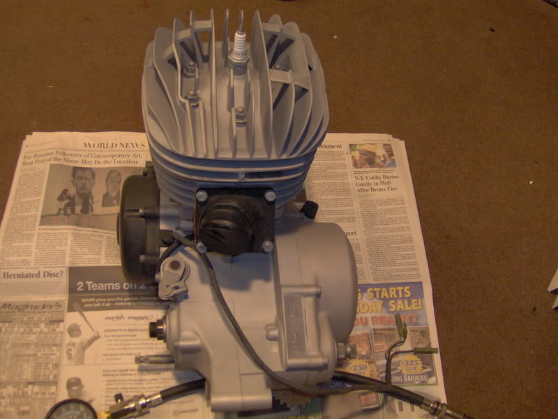

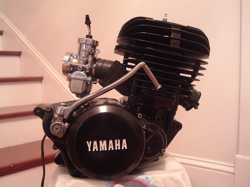

holly sh*t dude...if i dont lose my job this week,im gonna send you sh*t to blast..lol
