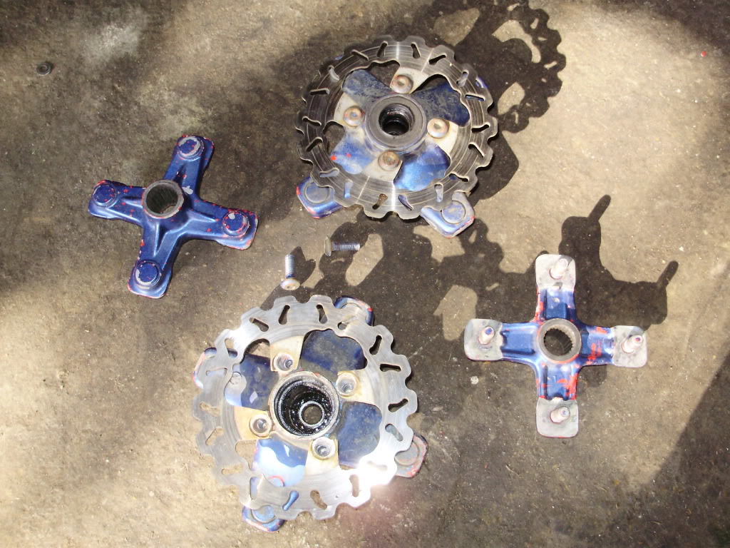

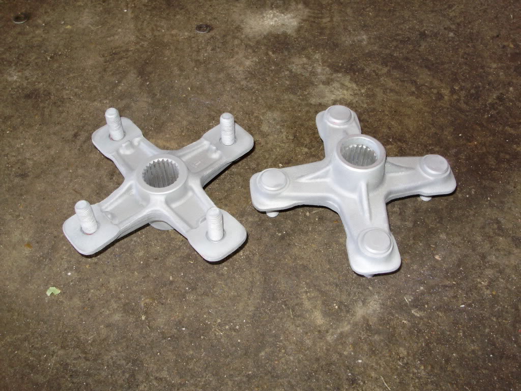

I did some Blasting on some Banshee parts today.
It is a dirty job, but for pre-paint and powder coat prep there is nothing better.
I always used aluminum oxide media for a good etch on the surface and glass media at low pressures for polishing
