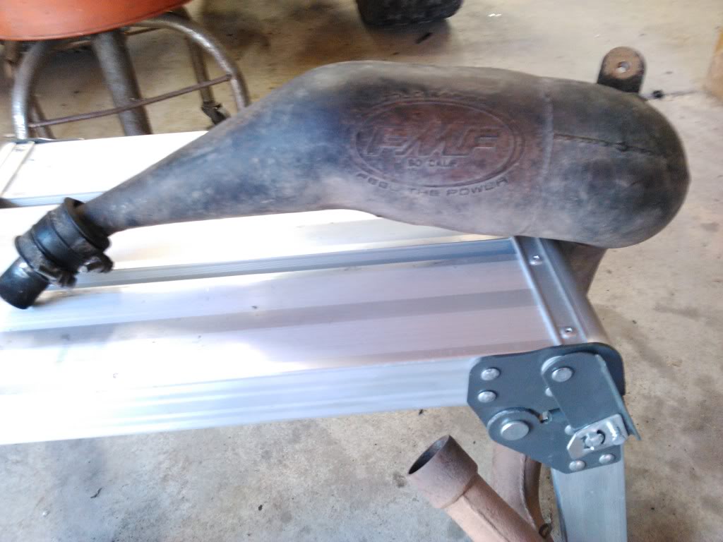

I decided to clean up my FMF Fatty expansion chamber today, and figured id make a little video of me doing it. I cleaned this pipe with aluminum foil and water and it came out great I think. The video was shot from my crappy cellphone so I apologize in advance about the quality, also I forgot to mention a couple tips in the video.

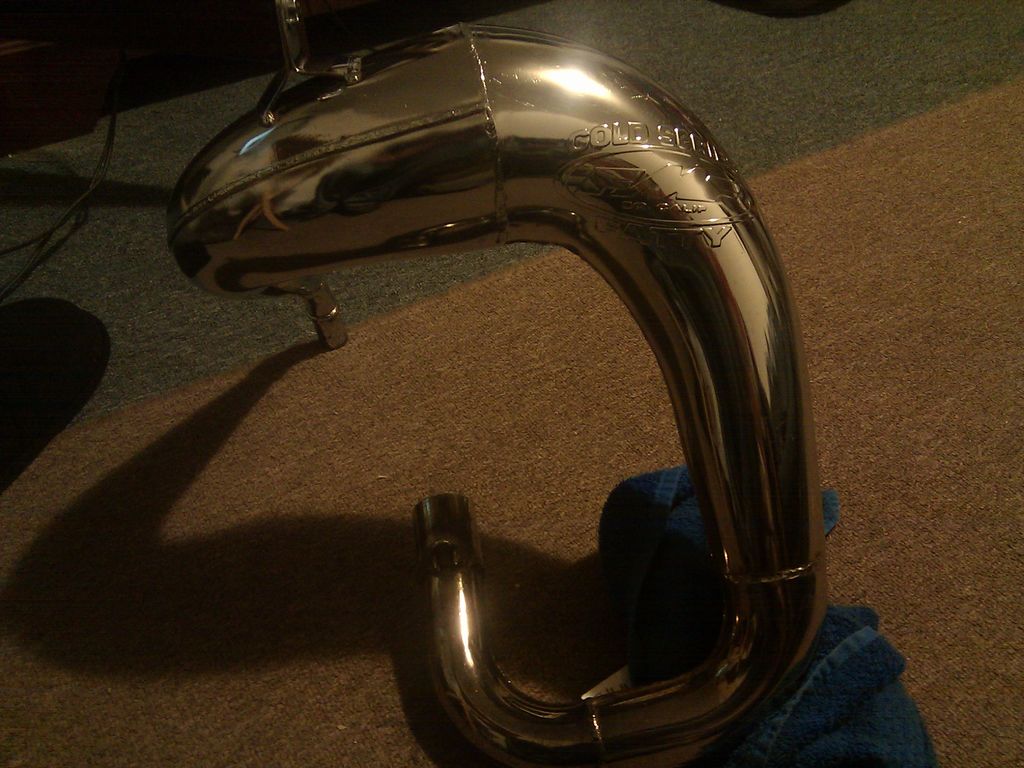

Here is a picture of the final product after I applied a little bit of mothers polish.

I am going to try this on this rough looking fmf.

After seeing this post I had to try it. It came out great. I used a little metal polish and a buffer to really shine it up. Thanks for the awesome idea.
