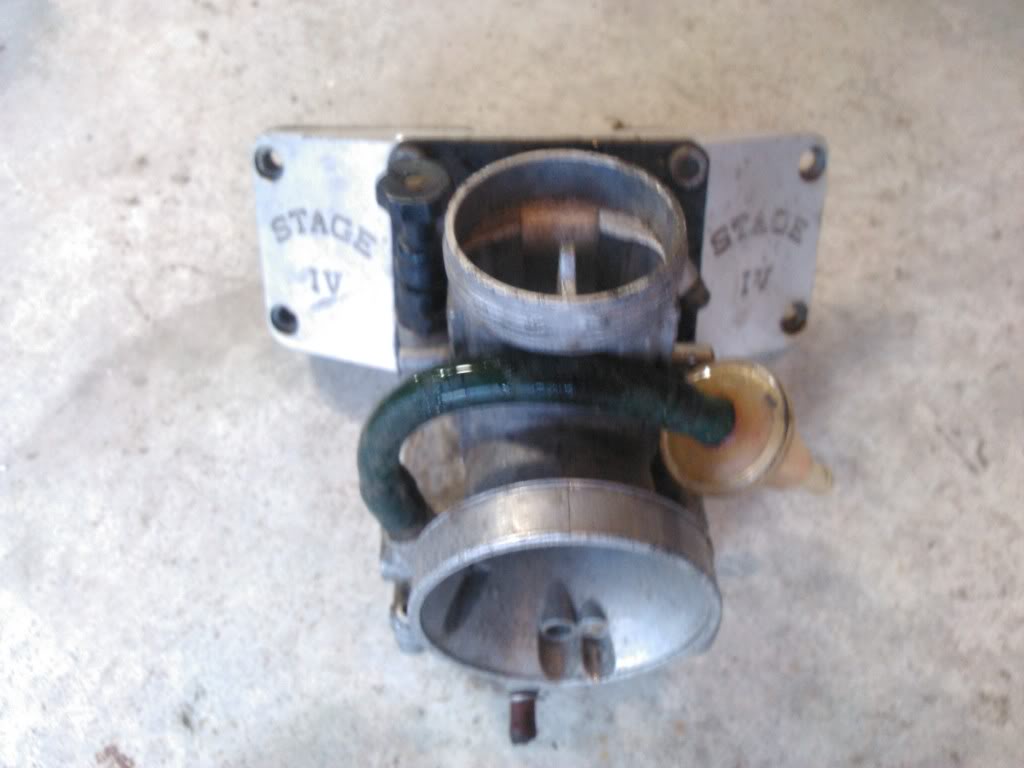

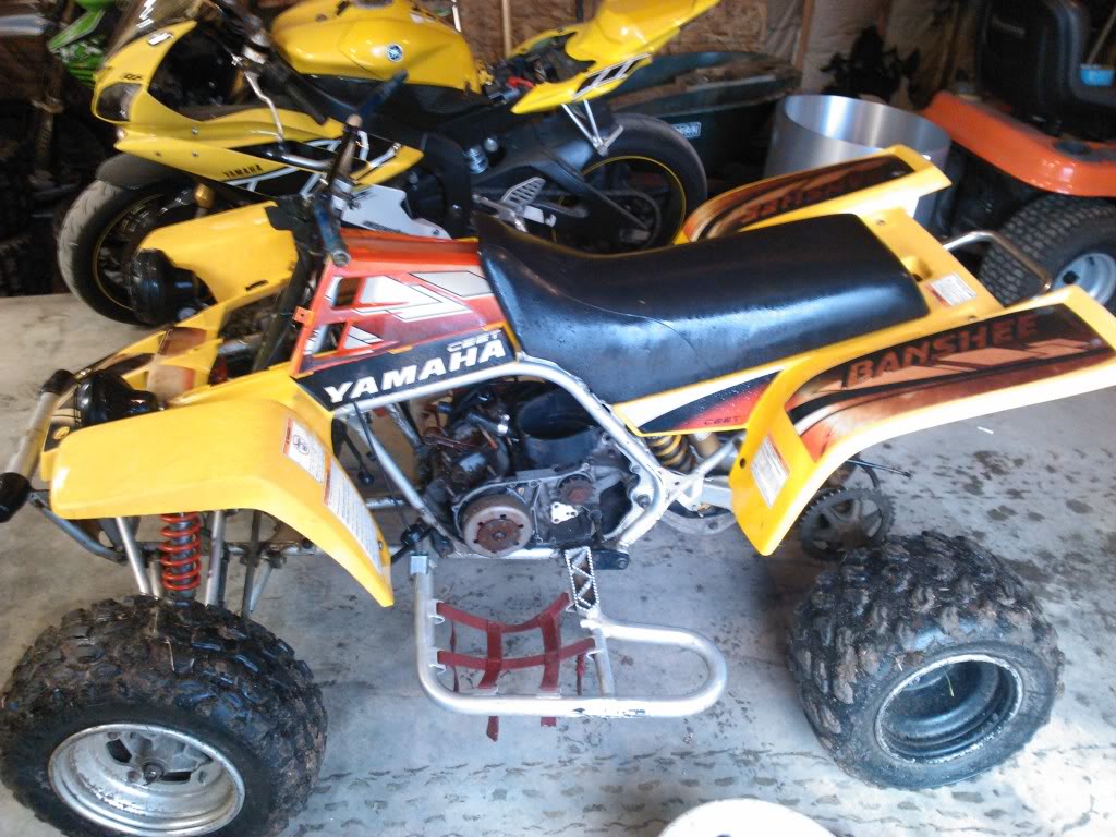

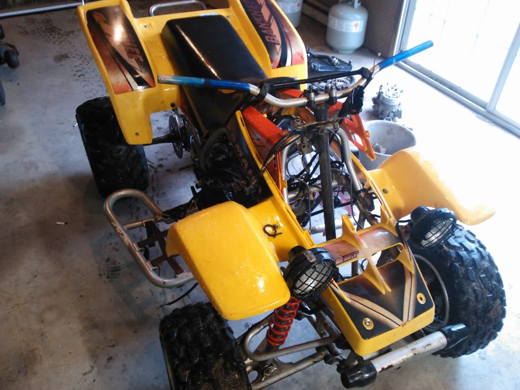

So this is the free banshee I got today. Looks like it's going to need a motor (1,000 dollars on ebay), rear brake caliper, clutch lever/perch, pipes, and an airbox. It had the 2 into 1 carb setup. I plan on selling that and going back to a dual carb setup. I know nothing about these bikes so I will be like a newbie. I will download the manual and read until my eyes bleed. This will be a long build cause I am not done with the blaster yet. Here are some pics.

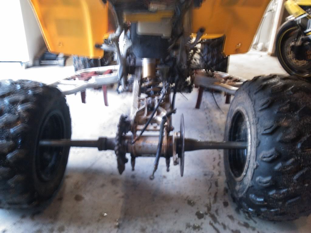

Wheels were not mounted tight.
The guy said he has the cool head and he will give it to me when he finds it. the bottom end has a puddle of water in it! I think I'll just get a motor on ebay and sell the parts from this motor.
Just another money pit! I just added up the total build on my black blaster and it came to 6 grand! That's after I buy $270 nerfs, $125 levers, and $170 decal kit. I'm going to try to keep this build a little cheaper.
Looks like you have your work cut out for you :eek:.

good starting point on the shee for a complete rebuild.
no way are you keeping that build cheap, shee stuff adds up quick !

the shee looks to be in good shape, minus the motor, some wreching and some tlc and i bet shell look great.

It was given to a guy down the street a couple years ago. He had way to many projects going on so he let it sit outside for a while. He said the bottom end was good, but as you can see there is a puddle of water in it now. Anyway he came over and saw my bikes. He said "Are you interested in another project, it's free." And the next day I had it in my garage. He has a LOT of toys, so I'm sure he's not going to miss this one. I will be running the vin later.
I ran the vin it is not stolen. Well at least not reported stolen. I also verified its a 1996. Only mods I have seen so far is Nerf bars, cool head, and trinity 2 into 1 intake with what looks to be a 36 pj carb.

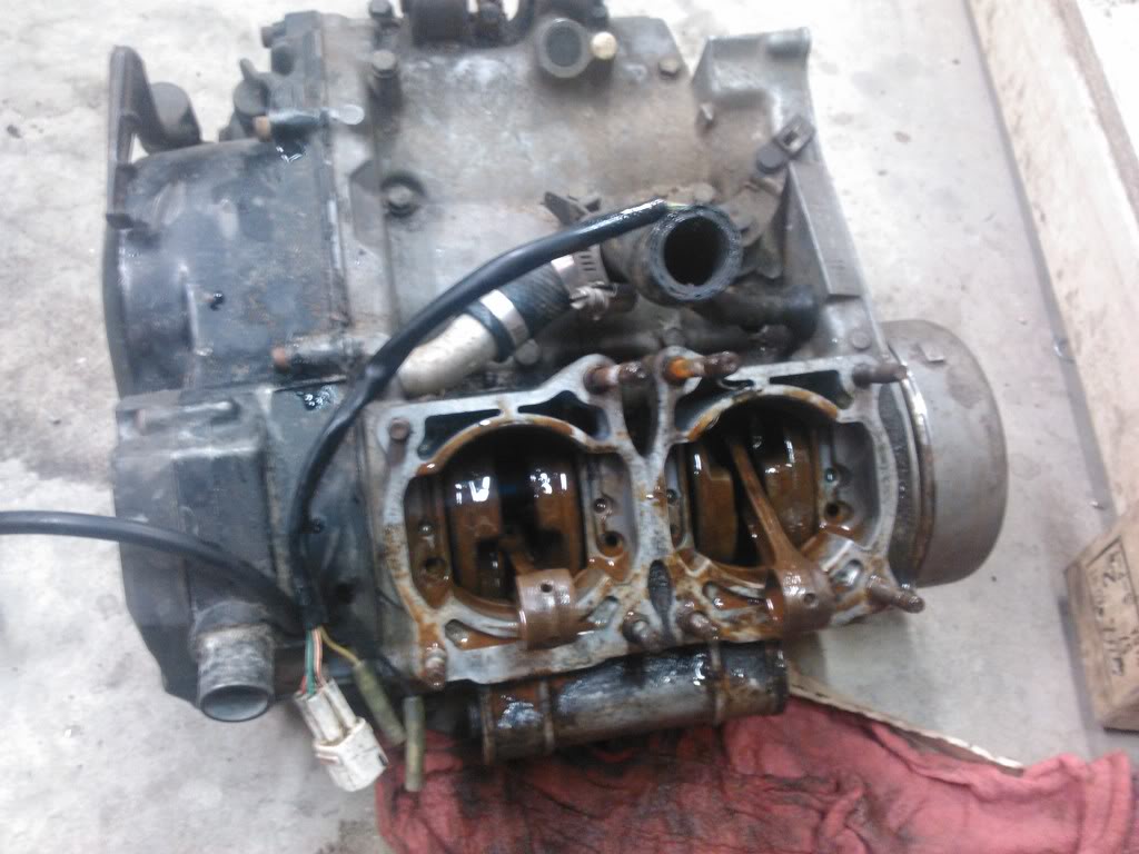

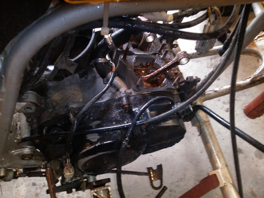

So here is the update. I went to unbolt the motor and it was already unbolted. The bolts were under the seat. So i yanked the motor and turned it upside down to get all the water/oil out. It was like a thick sludge.
So I got most of it out and filled it with degreaser. I know this wasnt a great idea, but remember I was already planning on getting a new motor. So it cleaned it up pretty good. I dumped it out and filled it up again with degreaser. Should be pretty clean after this wash. The crank spins very freely and the rod bearings have zero play in them. I'm now thinking I should split this motor and see what it looks like. If I could get away with main bearings and seals that would be awesome. It looks like rust, but like I said there must have been a lot of oil in there because it's like a sludge.
I cant download and print the manual until I go to work Monday. So I have two questions. (1) What goes in this whole by the stator wires and the clutch acuator?

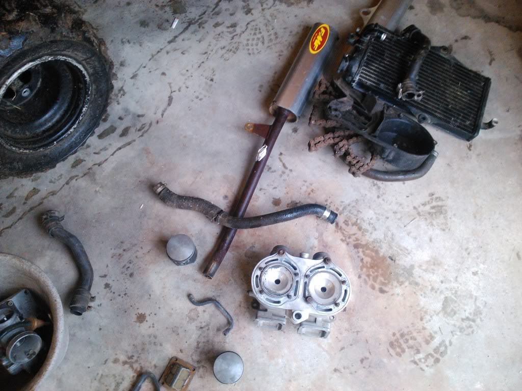

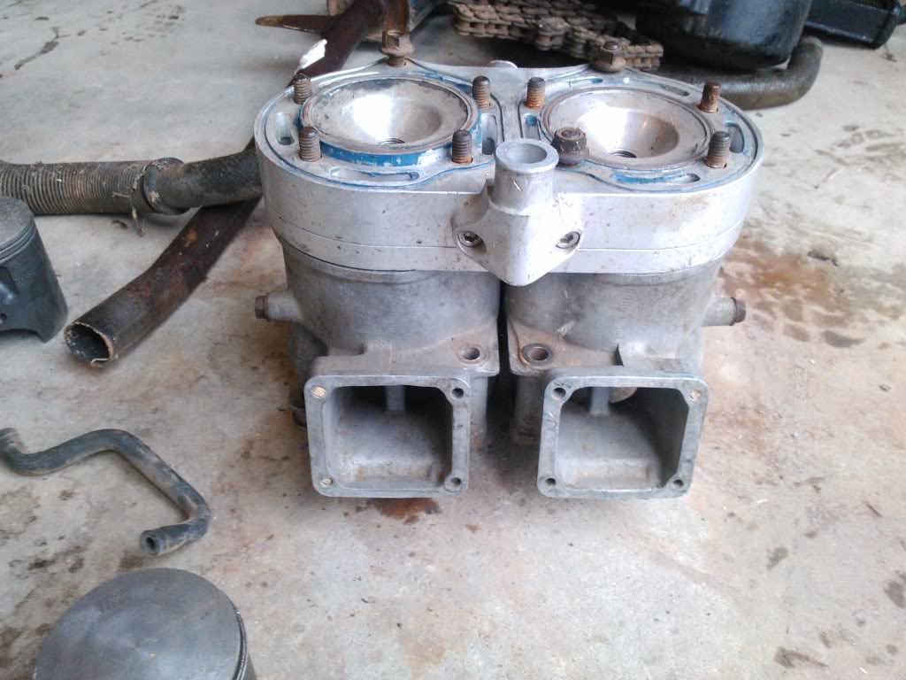

Question number two. This is a cool head what goes on the top of it?
I will have a manual soon and should be able to build it fairly easy. Right now I'm in the dark though. I have no idea how to route the coolant lines. I wont be doing that for a while anyway! :) So what do you guys think? All advice and suggestions is always appreciated.
Not going to do much on it today. Can somebody tell me what oes on top of the head and holds those domes in place.

The cases don't have any damage. Can you give me any ideas on a good setup. If I get this motor rebuilt I want to stroke it and get it ported. I don't want to have to trench the cases, so I'm thinking 4mm. Already has a cool head on it, but one of the domes is knocked up a little bit. So my question is if I do a 4mm crank what cc domes and what size carbs should I run? I plan on going with t5 pipes. From what I've read they are pretty good. I will be riding trails and tracks. Just looking for a good setup that won't break the bank.
