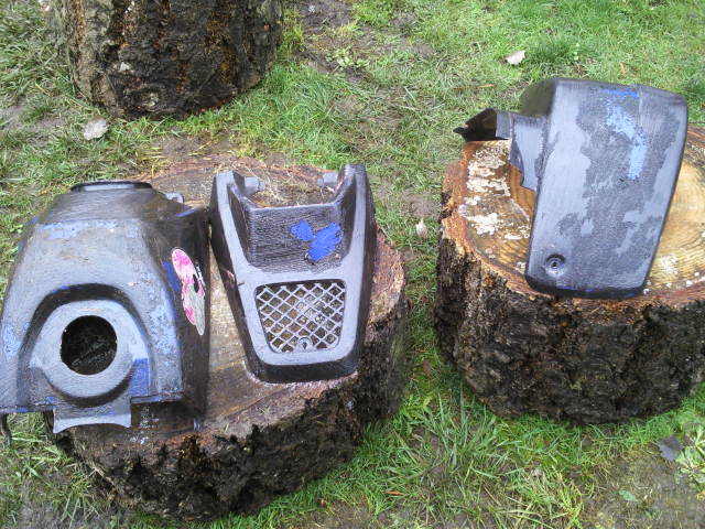

took it apart and letting the plastics sit with citrus gel right now to remove the old paint

The citrus gel is ok, it works, but aircraft stripper would probably work better if it doesn't eat the plastic.
After I let it sit for an hour I took a pressure washer to it.
Then did another coat to the paint still on it, pressure washed and now it's drying. I'll get the rest off with sand paper.
after first application
after second
I think the aircraft stripper would melt the plastic. I put some in a plastic jar when I was doing my frame and it melted a hole in the bottom.
