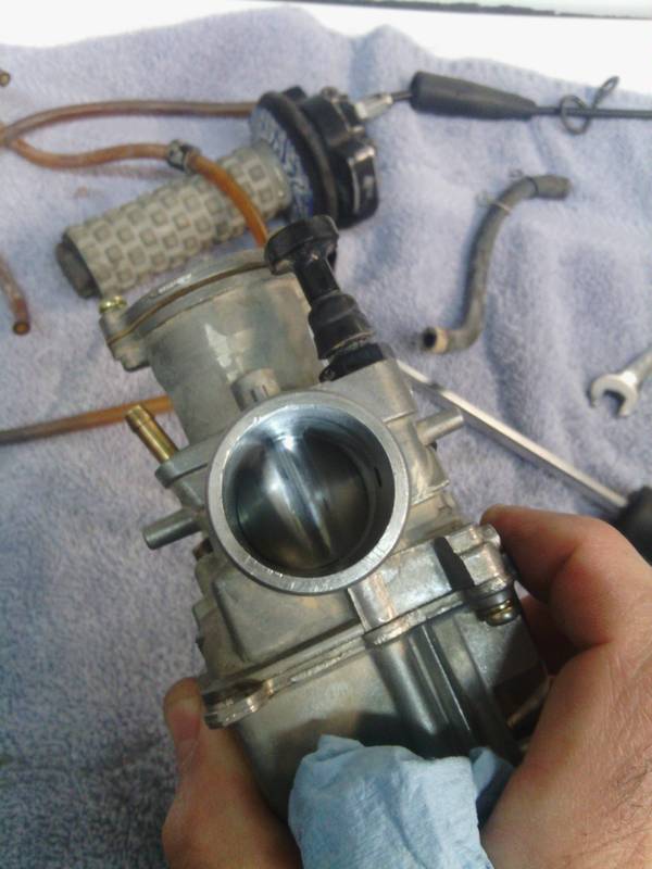

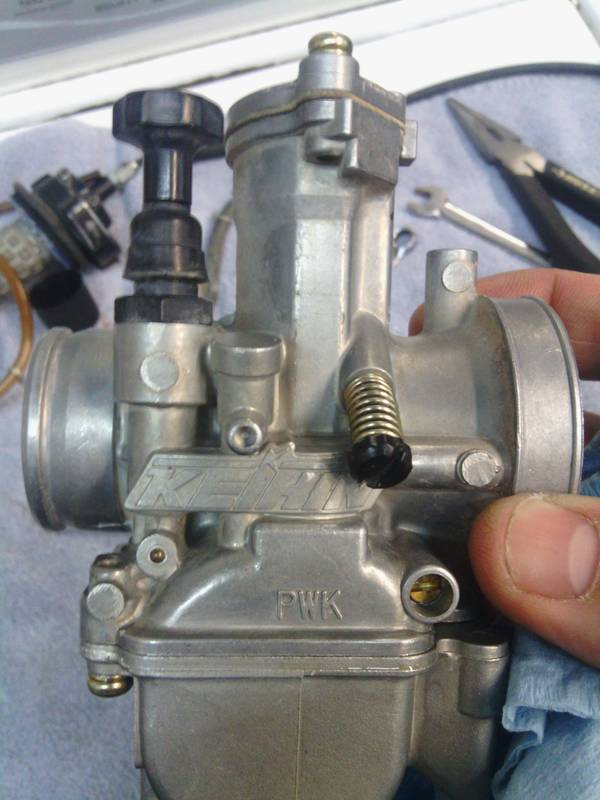

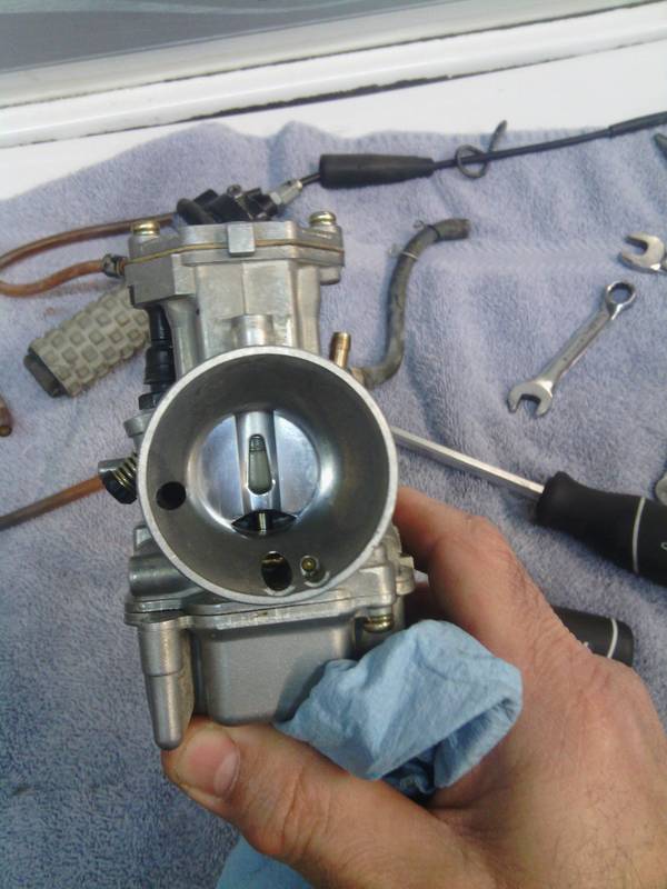

Came in yesterday...great shape . Came off a yz 85 . Pulled it apart to clean and get ready for the new jets and needle . I ordered the JJH and JJJ needles . Need to order a float needle valve...looks a little worn . Maybe by next weekend I'll get it in and start to jet it
