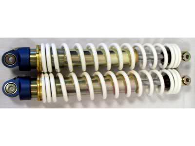

Question though, so this weekend I had a chance to pick up a cherry pair of shocks for cheap. I have long-travel arms made for 400ex size shocks and was able to score a pair of shocks and was hoping someone on here might know something about them.
They are made for a 400ex by a company called Engans in Sweden. I found there shop on internet but could not translate it ... so? I got warranty info and all the warranty/build paperwork etc. for them, called and there was a little language barrier . . . lol. According to the paperwork they were bought overseas for 750 pounds (uk) which is around 1100 american. I was told they're superior to ohlins another swedish shock builder but thats a tall claim. Took a chance for 150$ now trying to find some info. If anyone knows anything about Engans Shocks I'm curious.
Re: Finally Ready For Dream Build ... Need Engine Suggestions
i just did a little research on those shocks. i didnt find really any info except they are just as good as ohlins
That's what I keep finding on forums . . . that they are superior to ohlins. I did find out that they are made at a specialty racing shop in sweden that develops suspension setups for ATV's, Snowmobiles, and high end European vehicles such as Mercedes and Audi. The ones I have do not have reservoirs, I found pairs for 1600 British pounds that did have them on one site, so I would assume expense = high quality. My worry is servicing them . . . who knows, if they're really worth so much, my thought might be to sell them back to europe i.e. ebay uk etc. and use the money to buy some elkas or works. They are super sweet yet I don't want to ride them and then when I can't service them try to sell them and the price I could get now will be shot. Regardless I scored a sweet deal . . . As soon as i figure out how to post my pictures I'll post some of these shocks first.
I'm going to start uploading pics today starting with these Engans Shocks. These are actual pictures of shocks including all that I got with them. I found them for sale finally for 1100 and am going to sell this pair for a pair that better matches my blaster.
If any one is interested in these make me an offer here
ENGANS ATV HONDA 400EX, 450R, 250R, YFZ, LTR, SHOCKS - eBay (item 190480712149 end time Jan-14-11 18:21:03 PST)

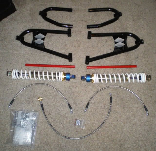

Here is what I was going to use for my front end. ASR long travels & tie rods, and streamline brakelines. I will be replacing these shocks however for a different pair that better matches the color scheme off my Blaster
