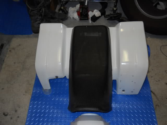

I know when i did my plastics there were afew really deep scratches that i just had to ignore. hell man they are just plastics on a quad. look in my build thread you can't even see the scratches in the pics but they are there. here i just went and got a couple pics from my thread. i started with 320 on my orbital sander then 400, then wet 800 by hand then 1000 wet by hand. and 3 coats of clear
BEFORE
AFTER
to get out the scratches, you have to sand a little, primer, paint, then sand a little again, paint some, and sand some more. like you said, with stock plastic, you cant just sand out the scratches or the plastic because very thin, you have to build it up a little with the primer and paint.
