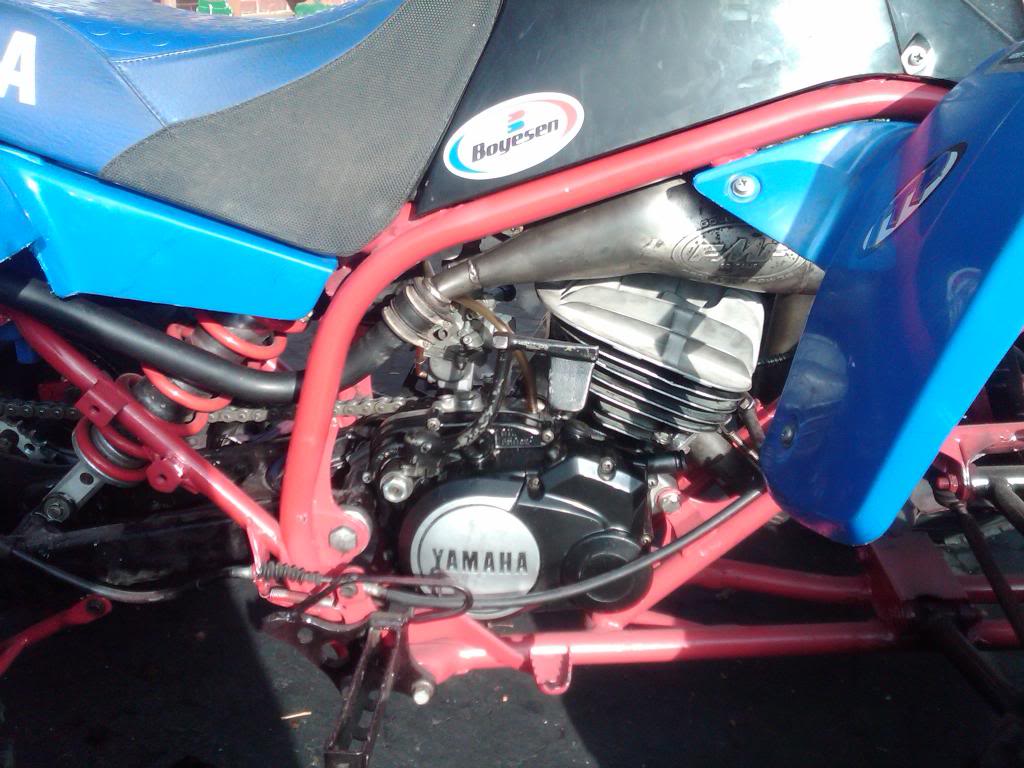

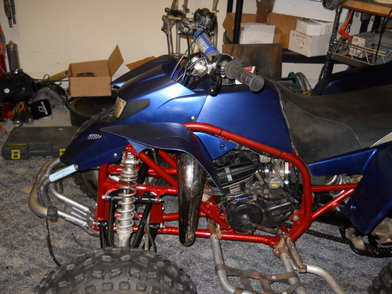

A Arms: Stock
Swingarm: Stock
Steering Stem: Stock
Stabilizer: N/A
Axle : Banshee
Carrier: Stock
Locknut: Stock
Hubs F|R: Stock
Bars: Renthal
Throttle/Clutch Lever: Tusk
Grips: Oury
Nerfs: DG
Bumper: Stock
Grab Bar: don't remember
Front Shocks: Stock
Rear Shock: YFZ 450
Brake Lines: Stock
Rotors F|R: Stock
Rims F|R: stock/ITP
Tires F|R: Stock/Holeshot 20's
Body:
Frame: 98 with 03 headlight bracket
Plastic: stock with/ 03+ headlight and hood
Graphics|Seat Cover: Stock
Number Backgrounds: None
Handguards:
Bar Pad:
Fuel Tank:
Engine|Drive System:
Cylinder|Head: rechambered/ mystery/flotek portwork
Bore & Stroke: stock stroke .060
Displacement: 197cc LOL
Cam:
Carburetor: OKO 30mm
Air Filter|Box: STD racing
Pipe|Silencer: Bills
Clutch|Plates: Driveline heavyduty
Gearing F|R: 14/40
CDI|Killswitch:
Cooling:

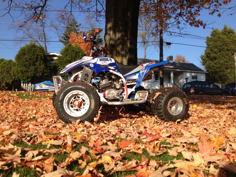

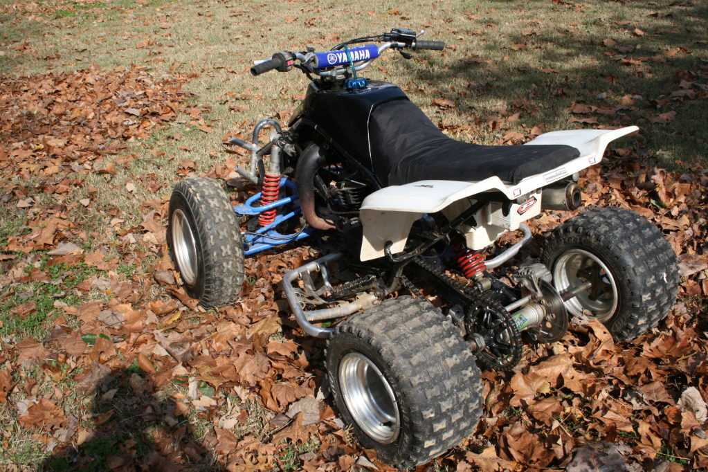

A Arms:stock painted blue
Swingarm:stock with boss bearings
Steering Stem: stock
Stabilizer:none
Axle :stock
Carrier:stock
Locknut:none
Hubs F|R: stock/yfz with +3 stud spacer
Bars: oneal
Throttle/Clutch Lever: stock/ shorty
Grips: scott
Nerfs: dg alloy
Bumper:custom
Grab Bar: custom
Front Shocks:stock with 1 1/2 lowering kit
Rear Shock:stock
Brake Lines:stock
Rotors F|R:none/stock
Rims F|R:yfz /yfz
Tires F|R:holeshot mx / holeshot mxr4
Body:
Frame:stock
Plastic:stock
Graphics|Seat Cover:custom
Number Backgrounds:5
Handguards: none
Bar Pad: yfz
Fuel Tank:stock
Cylinder|Head:stock
Bore & Stroke: 67.50mm/57.oomm
Displacement: cc204
Cam: are you kidding me 2 stroke
Carburetor: stock
Air Filter|Box:stock no lid
Pipe|Silencer:DG/DG
Clutch|Plates:stock/unknown
Gearing F|R:12/42
CDI|Killswitch:ricks hotshot /none
Cooling:air
Other:custom oil pump cover

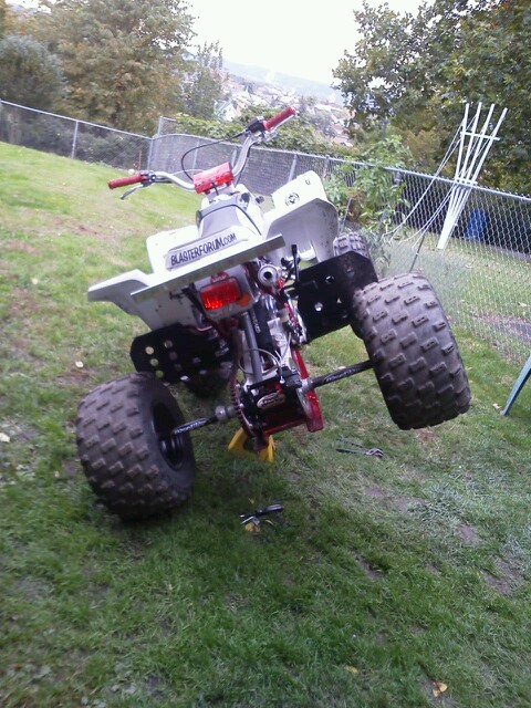

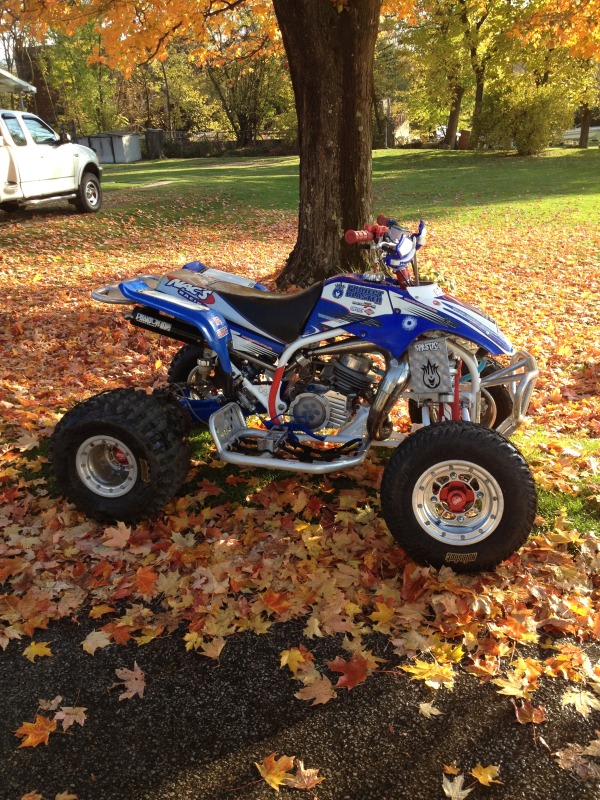

A Arms: Stock painted with Piviot works needle bearings
Swingarm: Stock-reinforced pc'd white
Steering Stem: Custom B-RAD 2.5" extended with antivibe clamp pc'd white
Stabilizer: Moose Racing stick type chrome
Axle : Durablue +3 eliminator
Carrier: Stock 05 pc'd Black-APC-James (little3mil)
Locknut: Durablue 3 piece aluminum
Hubs F|R: Front-Stock Rear- Shee pc'd white-APC-James
Throttle/Clutch Lever: SS braided cables/Moose racing levers
Grips: Oury red grips (the best) with billet red bar lock ends
Nerfs: are gay, I have custom made heelgaurds and pegs pc'd black
Bumper: DG old style
Grab Bar: Custom stainless Chromed by Steve (Oregondunes)
Front Shocks: Elka stage 1
Rear Shock: 400 LTZ'07 KOR Bushings pc'd black spring!
Brake Lines: All SS braided front and rear
Rotors F|R: Stock
Rims F|R: YFZ450 front and back
Tires F|R: YFZ450 stockers
Body: White/Black
Frame: Gusseted-Candy red two layer PC
Plastic: Stock blaster plastics black tank and white tank
Graphics|Seat Cover: Custom Blasterforum seat cover/ custom decals by Sporty, Decal Pros
Handguards: None
Bar/Pad: Zeta Hi bend ATV Longer than stock- silver/red pad
Fuel Tank: Stock W/ banshee petcock
Cylinder|Head: Ken Oconner Modified +3 stroked head/pump gas- SCD triple exhaust porting
Bore & Stroke: 66.75mm & 60mm stroke (+3)
Displacement: 210cc
Cam: newton
Carburetor: 33PWK & 35A/S
Air Filter|Box: Custom CFM Modified Aluminum
Pipe|Silencer: Toomey complete exhaust, head is ceramic coated silencer and stinger is polished polished o-ring clamp
Clutch|Plates: Hinson basket with driveline performance HD springs
Gearing F|R: 14/40 primary drive red chain 93 link
CDI|Killswitch: Stock
Cooling: The wind
Other:Custom B-RAD full skidplate HDPE 1/2", Diamondplate air scoops, Nology ignition system, cobra swinger skidplate, T&M roller chain guides and rollers and Cascade swingarm slider.

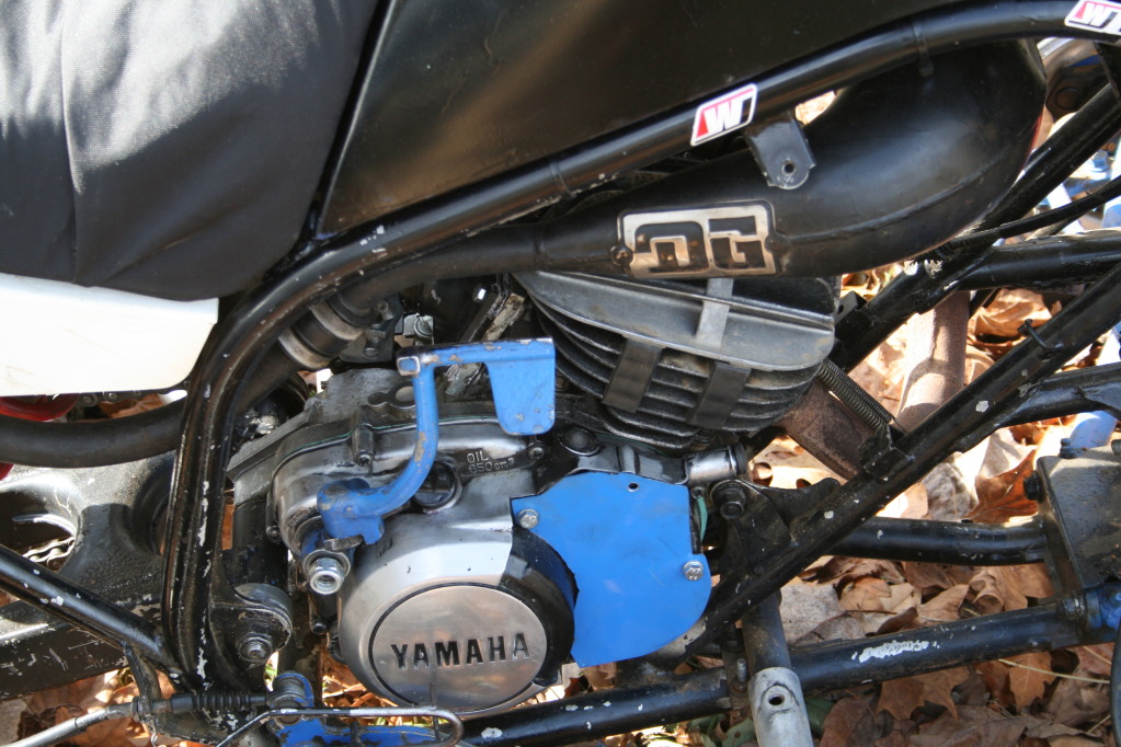

A Arms: Stock
Swingarm: Stock
Stabilizer: N/A
Axle : stock
Carrier: Stock
Locknut: Stock
Hubs F|R: Stock
Bars: stock
Grips: pro taper
Nerfs: none
Bumper: Stock
Grab Bar: stock, polished
Front Shocks: Stock
Rear Shock: stock
Brake Lines: motion pro
Rotors F|R: Stock
Rims F|R: stock/DWT
Tires F|R: Stock dirt, sandstar paddles
Body:
Frame: 02
Plastic: stock
Handguards: none
Bar Pad: renthal
Fuel Tank: stock
Cylinder|Head: stock
Bore & Stroke: stock bore and stroke
Displacement: 197cc
Cam: these arent 4 pokes
Carburetor: stock 26mm mikuni
Air Filter|Box: uni
Pipe|Silencer: full fmf
Clutch|Plates: stock
Gearing F|R: stock
CDI|Killswitch: none
Cooling:none
Other: tm designworks oil injection delete

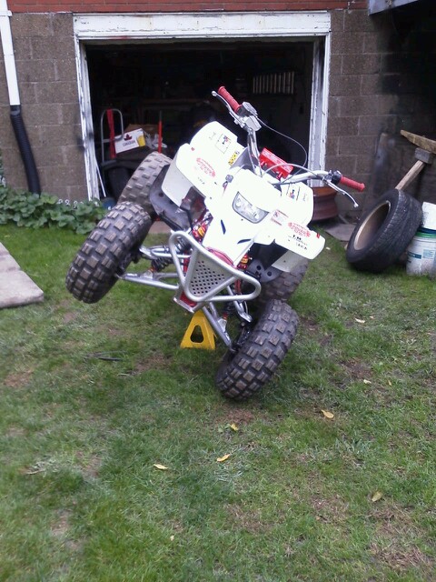

A Arms:stock
Swingarm:stock
Steering Stem:stock
Stabilizer:none
Axle :stock
Carrier:stock
Locknut:stock
Hubs F|R:stock
Bars:stock
Throttle/Clutch Lever:stock
Grips: spider grips
Nerfs:none
Bumper:stock thanks slickerthanyou
Grab Bar: yes its stock and painted
Front Shocks:stock
Rear Shock:stock
Brake Lines: stock
Rotors F|R:stock
Rims F|R:stock
Tires F|R:dunlop for dirt, gbc sandsharks for sand!
Body:stock
Frame:stock
Plastic:stock
Graphics|Seat Cover:ceet racing
Number Backgrounds:
Handguards:none
Bar Pad: Protaper
Fuel Tank:stock
Engine|Drive System: stock
Cylinder|Head:stock
Bore & Stroke:68mm
Displacement: 195
Cam:haha no this is a 2 stroke forum!
Carburetor:stock mikuni 26mm
Air Filter|Box:twin air
Pipe|Silencer:Full FMF
Clutch|Plates:stock
Gearing F|R:stock
CDI|Killswitch:stock
Cooling: custom air scoops
Other: nacs bar clamp, pep shock covers, 03+ hood and light conversion

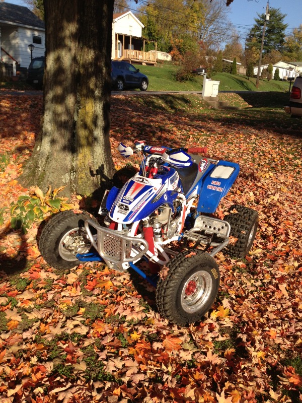

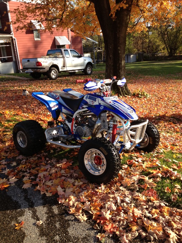

Frame: Stock w/ custom gusset kit
A Arms: +3+1 LSR
Swingarm: Burgard +2
Steering Stem: Burgard +1 w/Antivibe Clamp
Stbilizer: PEP
Axle: Durablue
Carrier: Durablue
Locknut: Durablue
Hubs F|R: Hardkor
Bars: Flexx (not Pictured)
Throttle/Clutch Lever: Terry Cable Billet throttle
Grips: Oury
Nerfs: Raptor AC
Bumper: IMS Roll Classic
Grab Bar: AC Wide
Front Shocks: PEP w/ SF Racing remote piggyback kit
Rear Shock: PEP
Brake Lines: SS
Rotors F|R: Streamline
Rims F|R: DWT Ultimate Billet Center Beadlocks
Tires F|R: ITP Holeshot SX
Body:
Plastic: Maier Race Cut w/ Quadtech hood
Graphics|Seat Cover: Project Blaster/ Nacs
Number Backgrounds: Spastic Designs
Handguards: Powermadd
Bar Pad: One
Fuel Tank: Stock
Cylinder|Head: ported Airsal 240 w/ custom water cooled head
Bore & Stroke: 72mm x +3mm stroke
Displacement: 245
Cam: top secret
Carburetor: 35mm airstryker
Air Filter|Box: Project Blaster/Uni filter
Pipe|Silencer: Project Blaster
Gearing F|R: 13/38
CDI|Killswitch: Prodesign
Cooling: Water cooled head with custom radiator
Other:TM designs flywheel and oil pump covers. Custom quick change clutch cover with lexan cover.

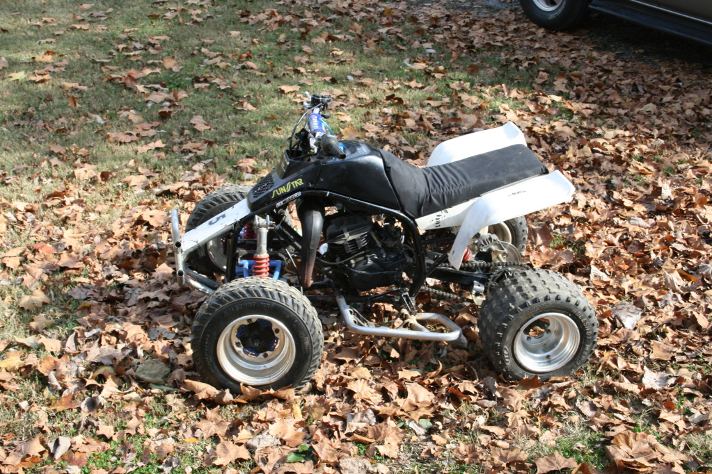

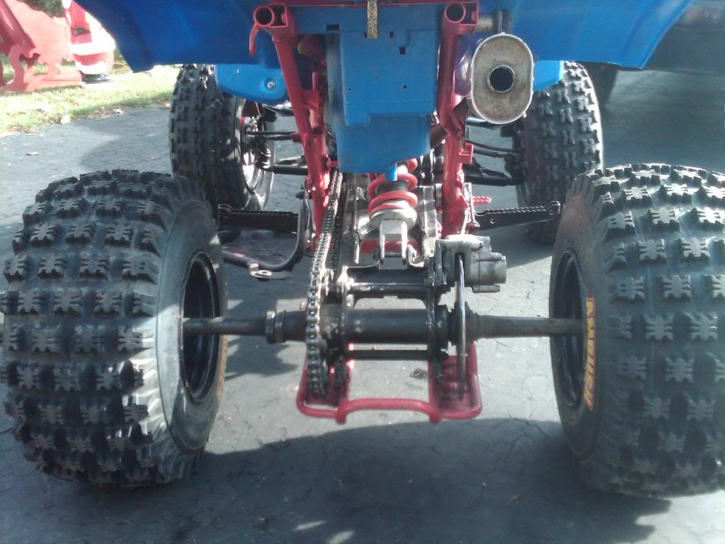

A Arms: stock painted black
Swingarm: stock black
Stabilizer:n/a
Axle : stock
Carrier:stock
Locknut:stock
Hubs F|R stock
Bars: unknown brand
Throttle/Clutch Lever: tusk clutch and stock throttle
Grips: unknown
Nerfs:n/a
Bumper: stock
Grab Bar: None
Front Shocks: stock pink
Rear Shock: 450r with ken occoner bushings
Brake Lines: stock
Rotors F|R:stock
Rims F|R: stock painted black
Tires F|R: itp front and cst ambush rear
Body: stock
Frame: stock painted red
Plastic: stock blue black
Graphics|Seat Cover: ceet gel seat
Number Backgrounds: n/a
Handguards: n/a
Bar Pad:n/a
Fuel Tank: stock
Engine|Drive System: re geared 1 tooth bigger in front 1 tooth smaller in back
Cylinder|Head: ken occoner redesigned head
Bore & Stroke: .10 over with stock stroke
Displacement:
Cam:
Carburetor: stock
Air Filter|Box: k&n filer with no box lid
Pipe|Silencer: fmf gold serious with powercore shortened
Gearing F|R: regread cant rememeber size
CDI|Killswitch: stock
Cooling:
Other: ports raised 1mm and polished
