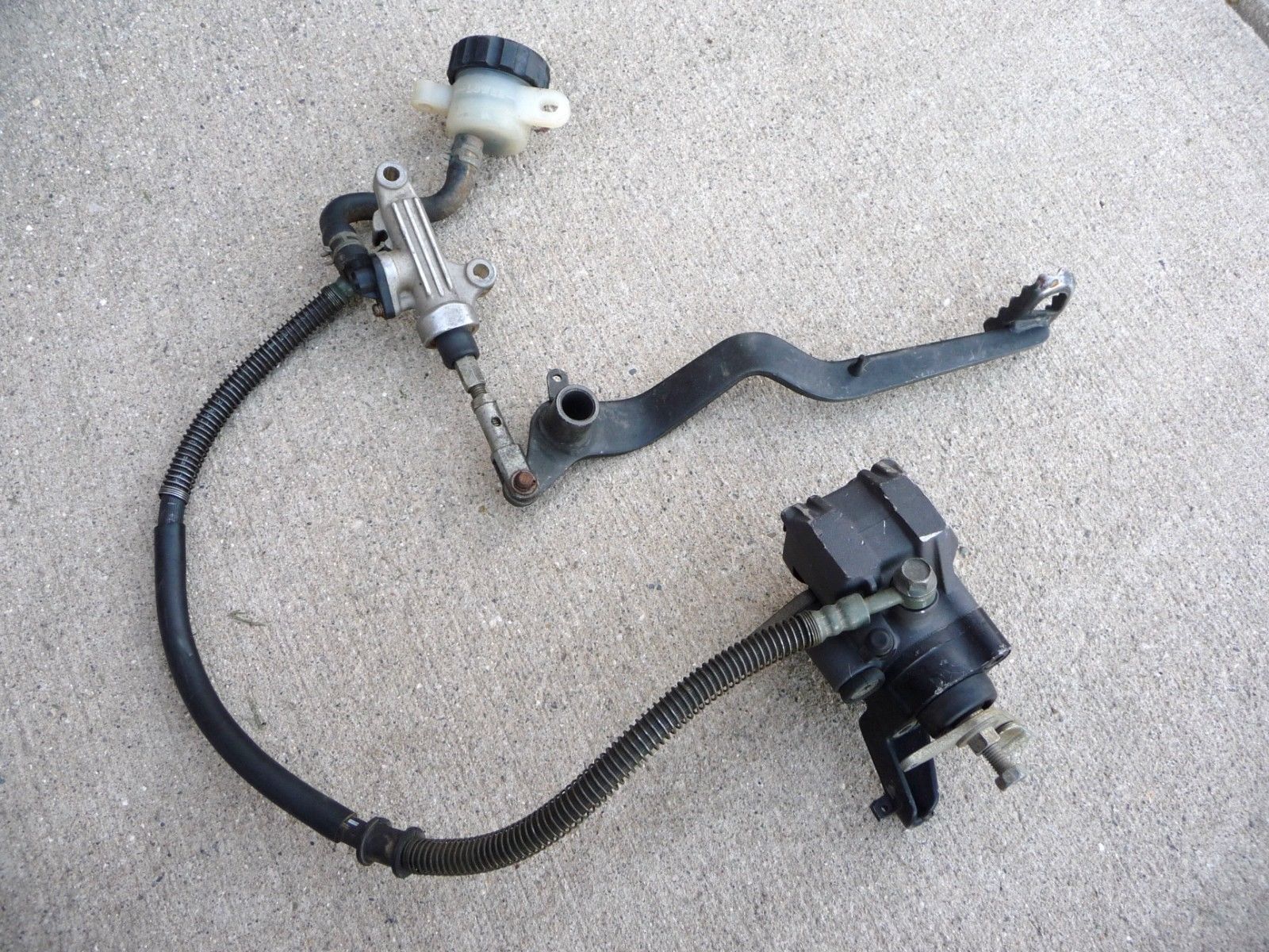

Hey guys, I am new to this site and just picked up a 2001 blaster. It came with rear hydro brake conversion done already. Problem is the caliper is bad and also needs a set of pads. I was hoping someone could help me in identifying what I have. Any help would be greatly appreciated.
looks like a banshee master cylinder with the offset mounting holes, I'd guess the caliper is too
the E-brake cable part shown on the banshee caliper below can be deleted
that looks like a banshee caliper, but is lacking the hole/mount for an e-brake ?
and the brake line connects on the bottom, instead of the top as most all yamaha rear brake calipers do ?
your best bet is to scour ebay for a matching caliper to identify it.
or replace it all, a yamaha sport quad caliper that includes the mounting bracket should bolt to that carrier
I used one like this................
