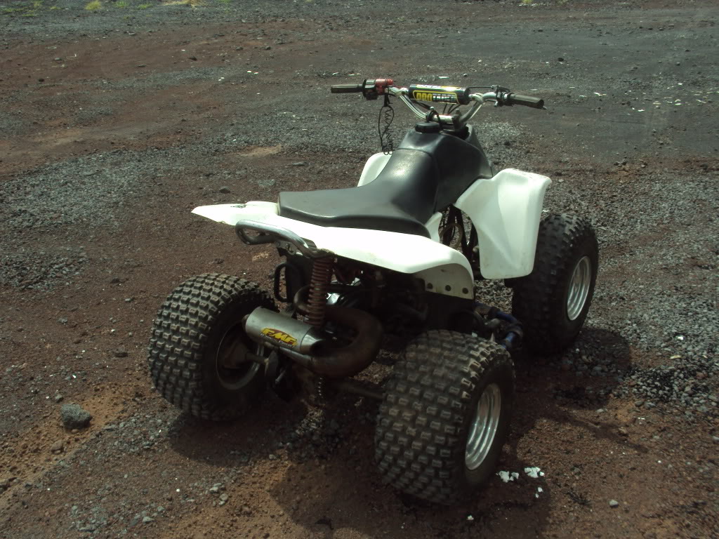

I got some snow hogs again for track riding here's a shot of how they compare they're 18x6.5"s the rear tires on the LT are 18x9.5 turf tamers fronts are 20x7 CSTs...
when I bought it originally it had 16.5" snow hogs on the rear. I have a set of 16.5"s too but wanted to try the 18"s :) also got a 14t front sprocket currently has a 13t so it should have similar top end and still wheel spinning off the line power. more so when the 26mm carb and Vforce setup is on it. it has retarded holeshot power lol. lifts up rediculously fast. can't wait til it's dialed in... still hoping to get a better bike but if I can get this thing running good I'd be happier...

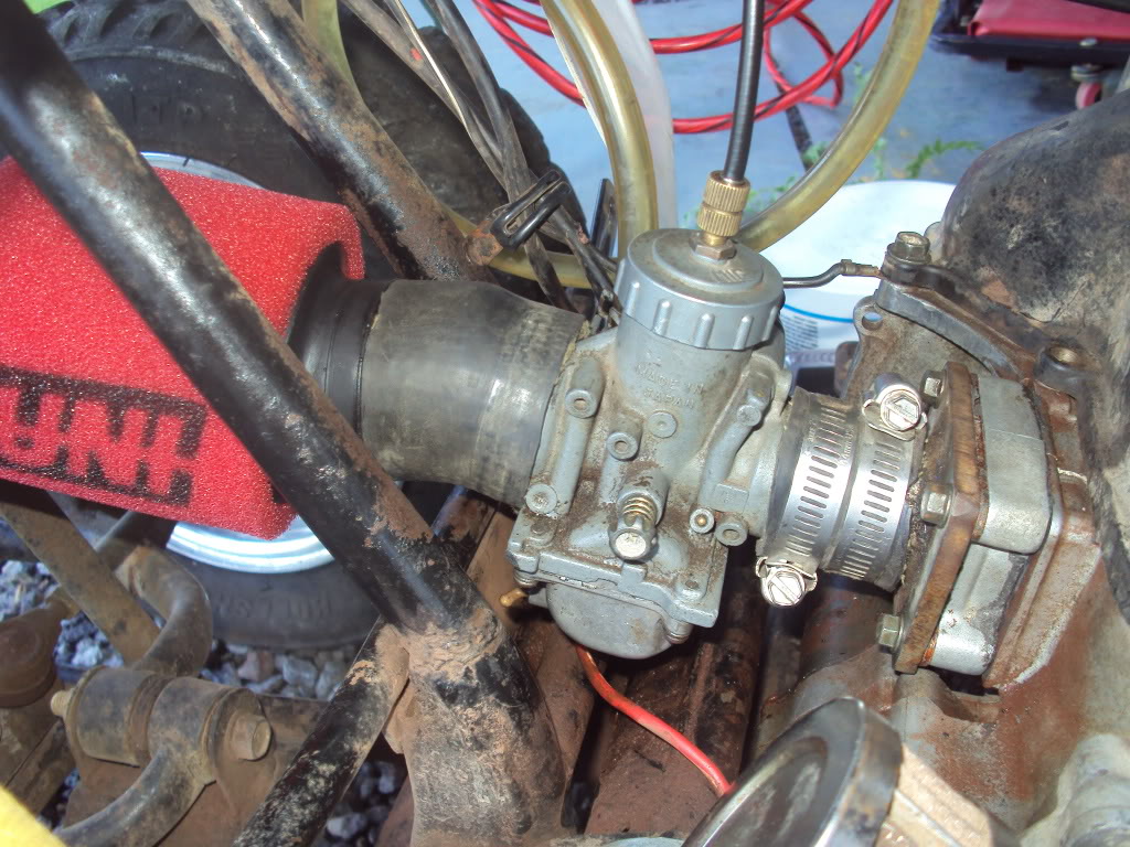

sooooo, I finally got all the parts to put the vforce reed cage and 26mm mikuni roundslide back on it AND working properly... It seems like it's a dirtybike carb so I decided to get a pitbike throttle and cable (proper length on draw/cable that sticks out of sheath) and since doing a twist throttle anyway, I put a 1/4 turn twist throttle on it LMFAO.. let me just say this thing is rediculous.. it scares me to ride it lol. it's very punchy like a dirtbike and unlike a dirtbike rider I'm used to holding the grip and when I go to turn and stuff or just general hold on it's full throttle lmfao...

carb shot you can see the spacer that holds the reed cage thing.. I'll pull it apart some time to get pix of the vforce setup :D
