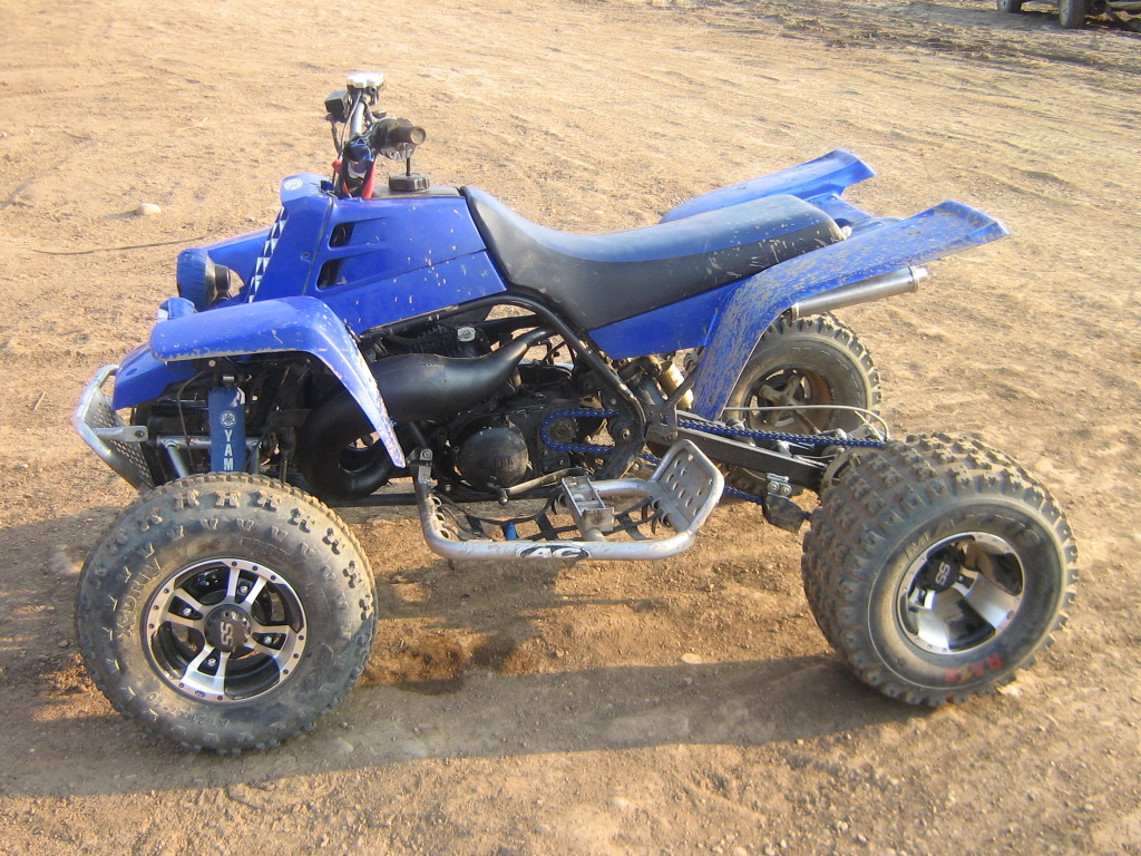

my big bore banshee build
just so some of you know i havnt given up.
teaser pic

shees all good up and running,
superior sleeve big bore.76mm wiseco pistons,hotrods trued and welded stock stroke crank,straight cut gears,hinson clutch basket,38mm mikuni mmx carbs,vforce3 reeds,shearer custom made big bore inframes,+4 swing arm,+4 axle,+4 timming,15/41 sprockets,itp ss mags.
bike rips in every gear
some say its 100hp.but theres no way to tell without a dyno tester.alls i can say its fast and seems like im missing a gear because i hit 6th gear in a heartbeat and it still spins out in 6th

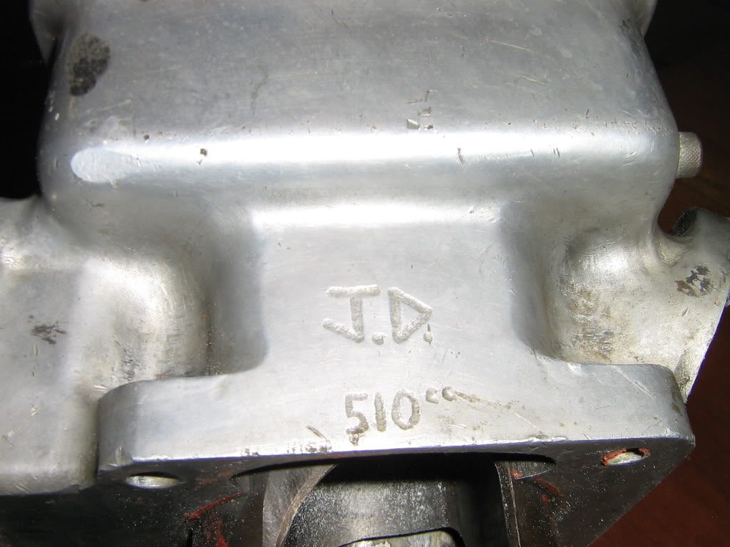

this 10mil.it should be in a museum lol

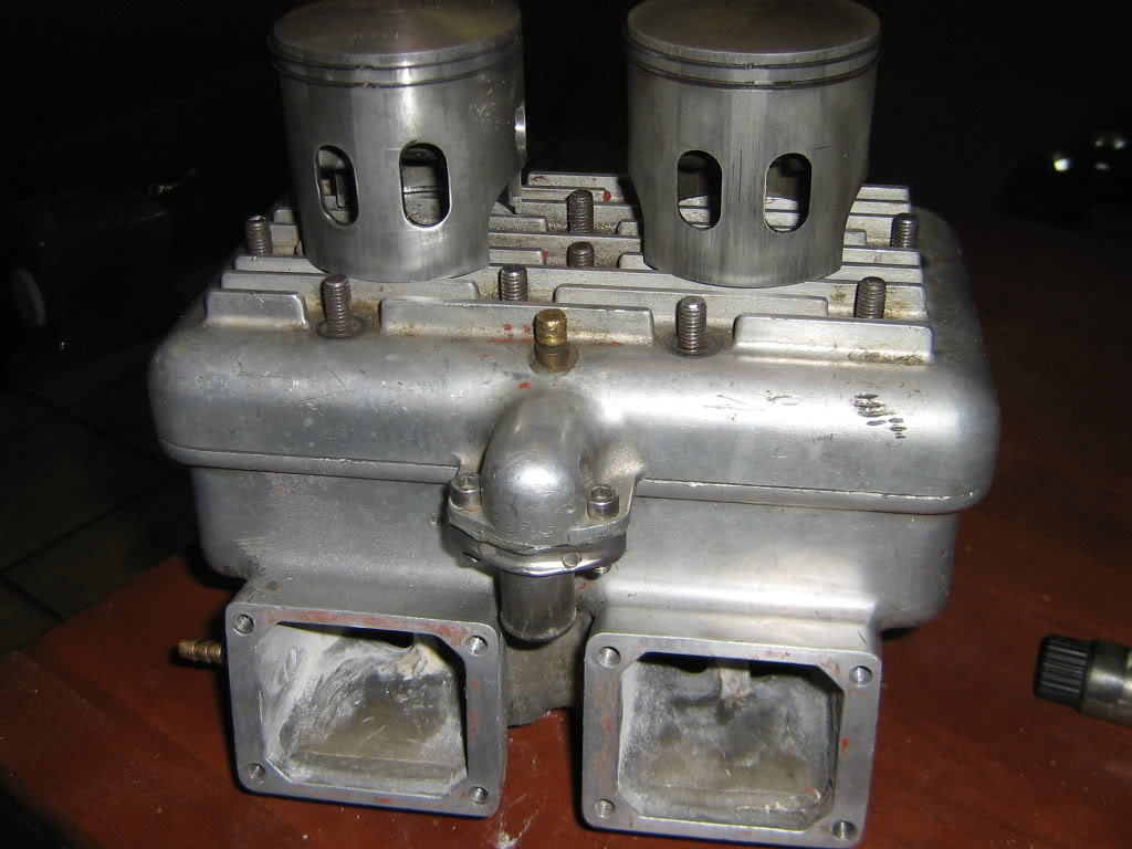

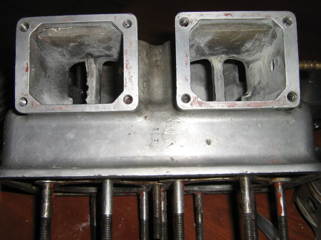

shee's an old cylinder i can tell you that much.i have some pics before i figured even things up with epoxy,thinking JD must of been hungover when he did this port work,idk.have a look for yourselves

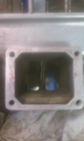

the center piece was in a mess the otherside was worse.
waiting for the epoxy to harden so i can knife out the center piece(hope it dont break)
the exaust ports are in a mess as well.
