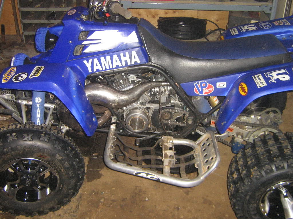

my big bore banshee build

but on the way i have straight cut gears.i have a better clutch cover lined up for next pay.and just need a few odds and ends then its go time.we will find out what this ss jug has i got a helmet cam on its way as well to,ill take some vids.

got the ss fired up.damn i should of bought new straight cut gears.if it wasnt for the used ones i got the bike would sound great.think i might get a new set soon and proper carbs
