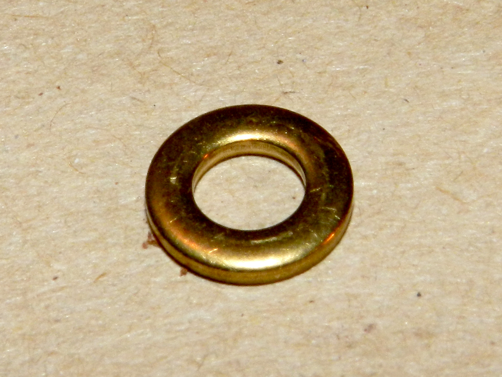

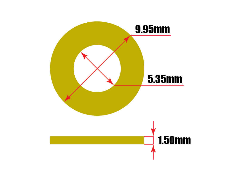

Maybe helpful. I know a lot of people have had problems with this washer missing on there bikes.
137-14153-00-00 YAMAHA WASHER,MAIN JET

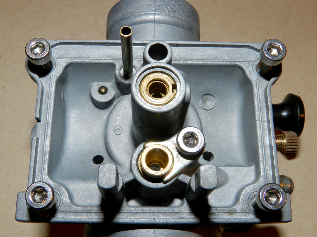

Without washer.

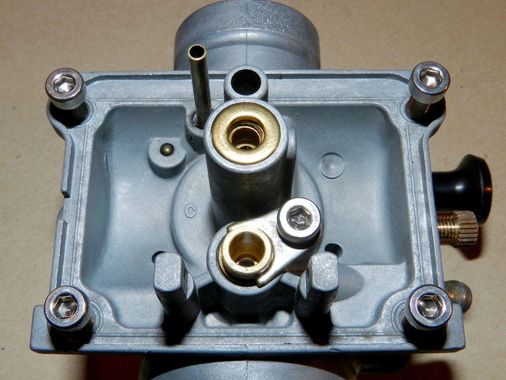

With Washer.

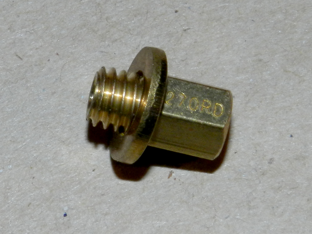

With washer and jet.
