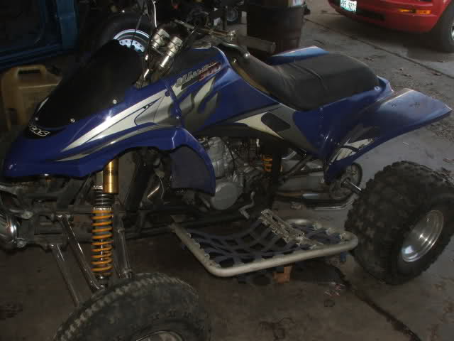

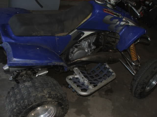

I was in a hurry when I did the hardest parts so no good pics but I'll get some. Engine fits IF you cut some of the swingarm bearing area off on the left side and modify the area of the frame running from the front shock mounts down to the lowest section close to the bottom of the engine. KX500 engine is just a little bit too long and hit those tubes so I cut about 6" out of them and welded some new sections in along with motor mounts. Custom pipe and radiator brackets of course, and the gas tank is TIGHT against the spark plug, but it's in there and yeah, TORQUE!!! HAHAHAHAHAHA!!
