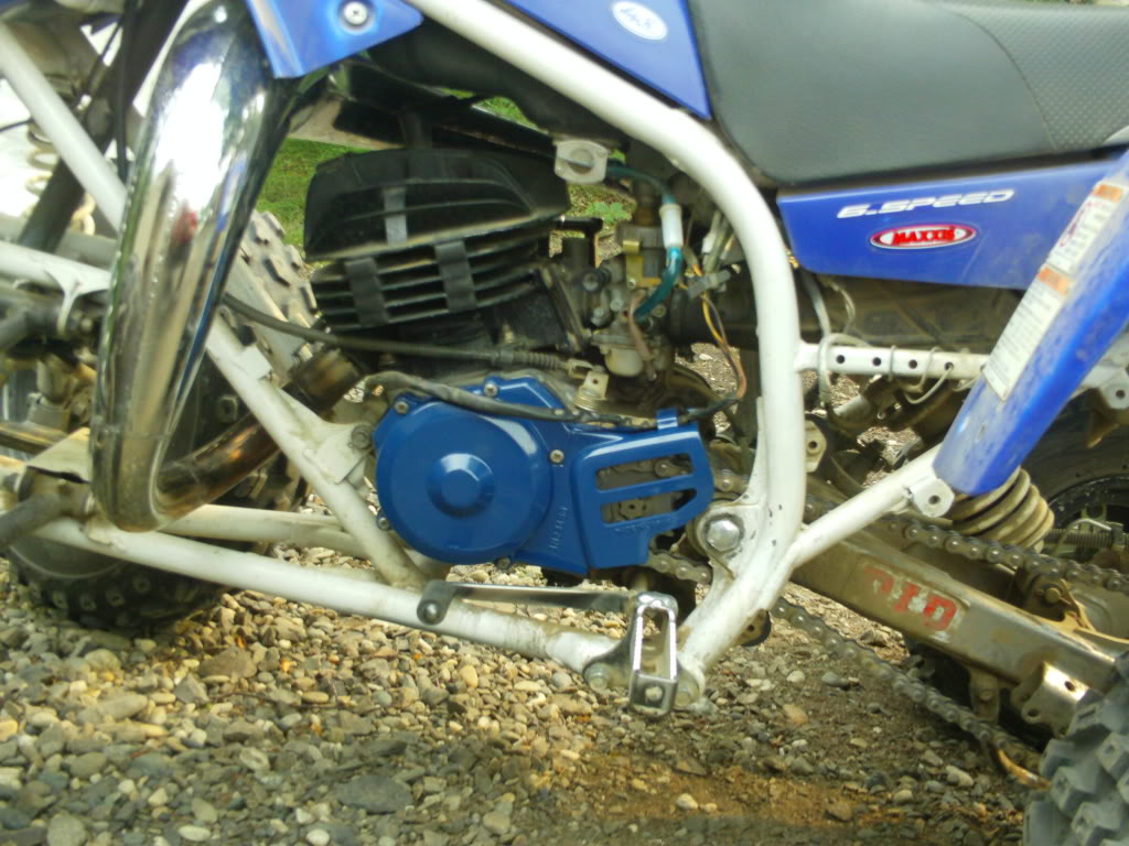

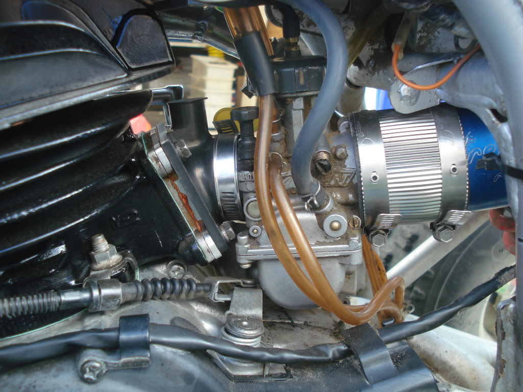

So when i got my blaster the clutch was jerry rigged on the case. Can someone take a picture(or point me in the direction of one)so i can hook it up correctly. I also noticed the one of my front wheels was sticky when i spun it so i took it off then took the bolt with the cotter pin off. Should that drum just pull off? I pulled on it some and it didnt want to come off all the way (and i didnt want to force it) and when i turned it black dust came out of the spot where the drum separated a little. are my brakes fried? and do i just have to pull on it really hard to get it off?
Does this pic help any?
As far as the drums go I don't know.. I've only owned my 03' with hydros, but I imagine it would pull right off? Are there any bolts holding it on or together?
That does help a little actually. I see that it bolts on to the jug. so i guess i need whatever bracket is holding it there.
