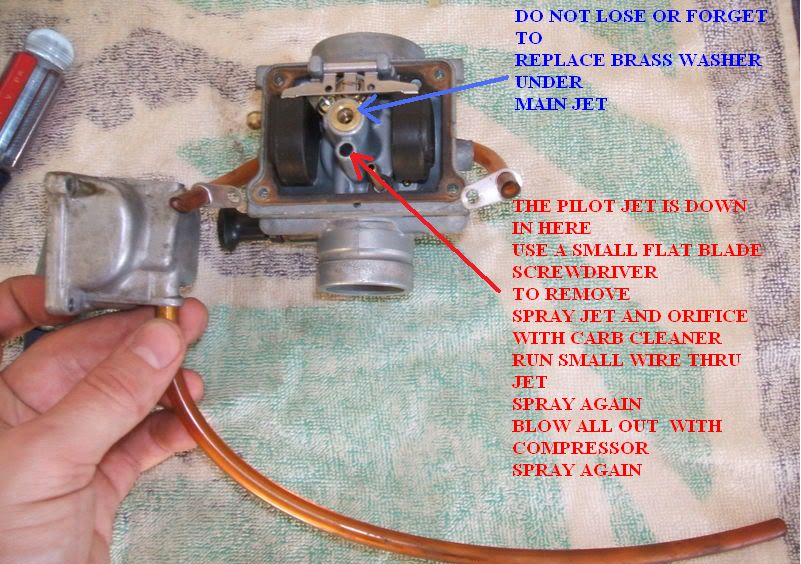

5.This is what you should see. The brass nut in the center is your main jet. (usually this will get gummed up or clogged, spray this whole area with carb cleaner but try to avoid the gasket)
6.Remove the main jet and plastic shroud and spray them (the jets are usually brass so be careful)

11. PILOT JET:

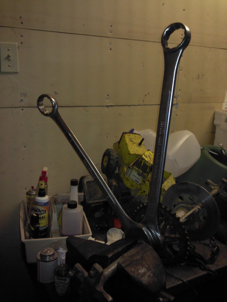

Heres my HUGE 24" wrench. It was cheaper at harbor freight than buying axle wrenches from rmatv.
Thats my blaster axle laying next to it. (just a random extra)

LOL, my dad said I was nuts when I brought that wrench home. He was like "when the hell are you gunna use that". I simply replied "when sh*t wont come loose".
Thanks guys.
lmao thats what a electric impact is for they dont have as much power as a air impact wrench but always does the job for me...
i got a hell of a steal tho i helped my buddy move and he gave me one for helping i was like heck yes another tool to add to my collection
Holy old thread batman. Big wrench ftmfw
And for you youngsters, look tonka trucks used to be made out of metal!!
Was just looking at that tonka truck.that thing brings back memories...you want part with it...I:I:D. ????pm if so..thanks..
