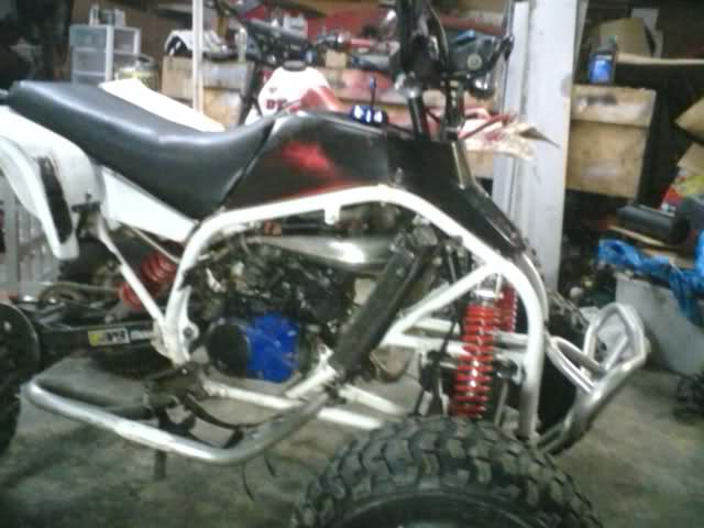

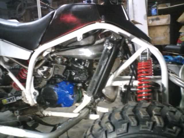

Dt200 motor swap (pics)
went hard at'er and got it together
still need the rad hoses and the antifreeze, good setup keeping the blaster gears but no powervalve :(
Why no PV? 15 15 15 15
There was no powervalve servo or wiring on this engine as it was bought.
Makes the swap easier with no wiring or battery needed.
He got the top end swapped over, waterpump side cover and the rad on in an evening.
May install a powervalve servo in the future if we pick up another bike.

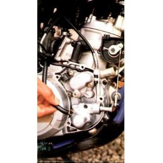

There was some talk of needing a different plastic gear for driving the waterpump.
All the DT sidecover parts seemed to swap onto the Baster with no problem.
The crank and clutch gears seemed to be the same size on both engines.
Is there something we are missing here?
Right now I have the KTM 250 Blaster sprocketed 3mph faster than his aircooled Blaster.
I may have to sprocket up a bit after this...
But then, with his brakes it is better to have him in front of me!

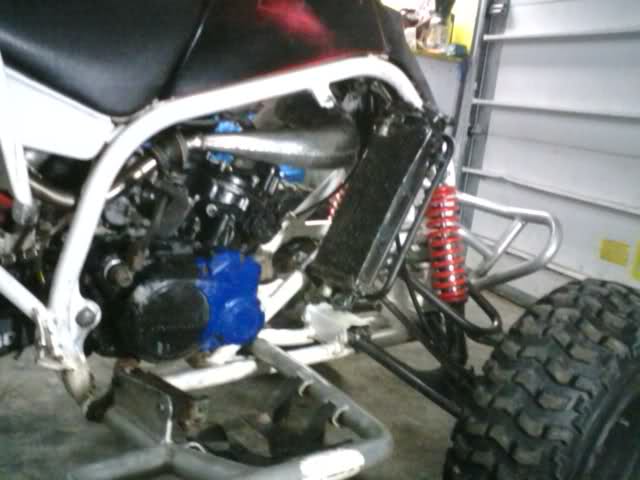

It runs!
Hope I am not stealing Triplecrowns's thunder, but he got it all together this afternoon and we went for a run.
It runs hard, noticably harder than the stock Blaster, but more peaky probably due to the fixed open powervalve.
It was no problem keeping it in the powerband, and it ripped along pretty good.
Jetting was an issue, requiring much richer. Don't know why, but weather is very cold here at -7C, so that is an issue too.
Hard to tell if the single rad will do, it worked fine in this cold weather. The DT200 has never overheated in slow trail riding. We'll see.
Bike is a bit quieter I notice. Idles excellent. Tidy installation. MUCH easier install than an MX engine like I did.
I did a piston quench gap test and it is very open at over 0.060" (my lead size) so lots of power and torque improvement room there.
I think there is some possibility of using backpressure to open the powervalve, running a line from the pipe to a large diaphragm to open the spring loaded valve.
Any idea what the typical backpressures are at mid range and full throttle?

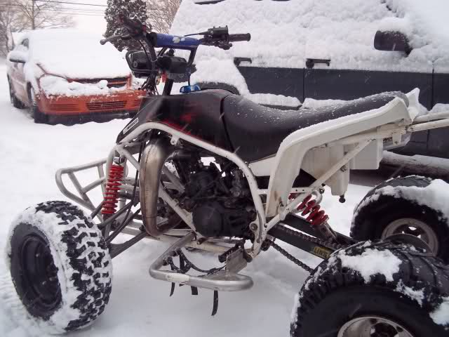

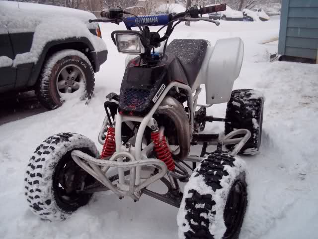

got some better pictures
the bike is running better with the dt carb and a 340 main jet. another added bonus with the swap is the boost bottle. hard to squeeze it on the aircooled motor due to the large cylinder and head.

It was a surprisingly easy swap actually.
This early 84 DT200 has the same primary drive ratio as the Blaster,
maybe the later DT200's have the different primary ratio and need the different plastic pump drive gear?
I think a fella could do something with the injection pump aux cable running the valve.
Closed valve at closed throttle and full open at WOT. That would do the trick.

the bike worked awsome for while........ till it popped the exhaust side of that damn CAST piston..X(. ended up splittin a crack in the bottom end and ruined the cases.
I think it was a case of alittle to many RPM's and motor getting alittle hot. i should of upgraded from the simple little dt radiator but this works awsome for what it was..... it blow on a hot summer day in a sand pit....i may have been abit hard on it, i was out with a banshee..:p
The head and cylinder are still mint tho didnt get damaged in the carnage.... luckly
plan do use them again someday. One wild set-up.
