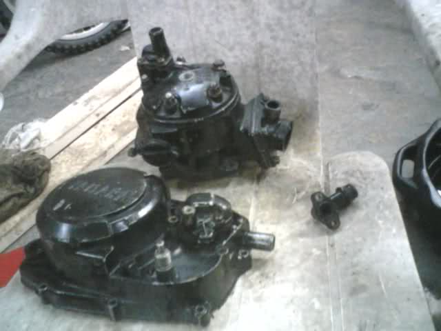

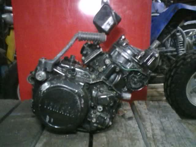

two days ago i found a dt200 parts bike forsale on kijiji for $250 so i immediately called the guy and went down and got it. i ended up paying just $140 for the whole thing :) i dident think that was too bad :p (sorry to you guys in the states this is probably killin ya). soinstead of ripin my good dt200 apart im gonna use this new parts bike motor for the swap to the blaster.
two days ago i found a dt200 parts bike forsale on kijiji for $250 so i immediately called the guy and went down and got it. i ended up paying just $140 for the whole thing :) i dident think that was too bad :p (sorry to you guys in the states this is probably killin ya). so instead of ripin my good dt200 apart im gonna use this new parts bike motor for the swap to the blaster.

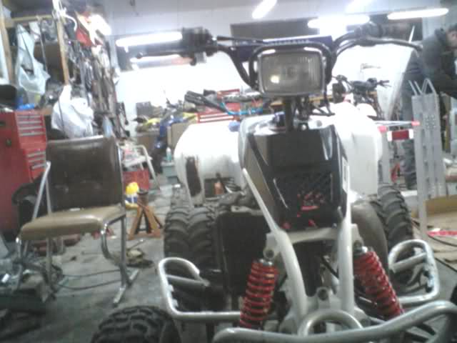

the blaster the motor is going in.
now just debating on weather i use a blaster bottem end with the liquid cooling components or to use a dt bottem end with the blaster tranny and drive gears installed. both are big changeovers. the main issue is trying to get the dt waterpump gear to run off the blaster drive gear.

these motors are still rare in cananda. im on kijiji all the time and the dt200 i bought was the first one that has been on there in a while. and ill sure as h3ll never find another here for $140 again.
the waterpump gear runs off of the blasters drive gear just fine so the dts side cover is a direct bolt on to put a waterpump on the side of the oem motor i guess to run my setup all i gotta do is liquid cool gear and stock blaaster jug.

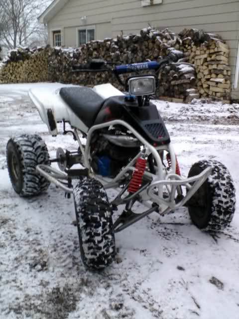

Glad to see this thing coming together! Now you'll need some front hydro brakes so that you can actually stop the beast once you get it put together. lol.
ya for sure, a newer set of stock hydro brakes would do the trick. need a back aswelll i wonder if the dts front caliper will work with a pedel on the blasters back brake.

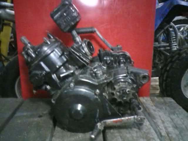

all parts needed for the swap other then the piston

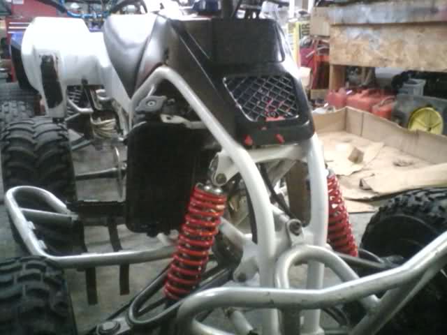

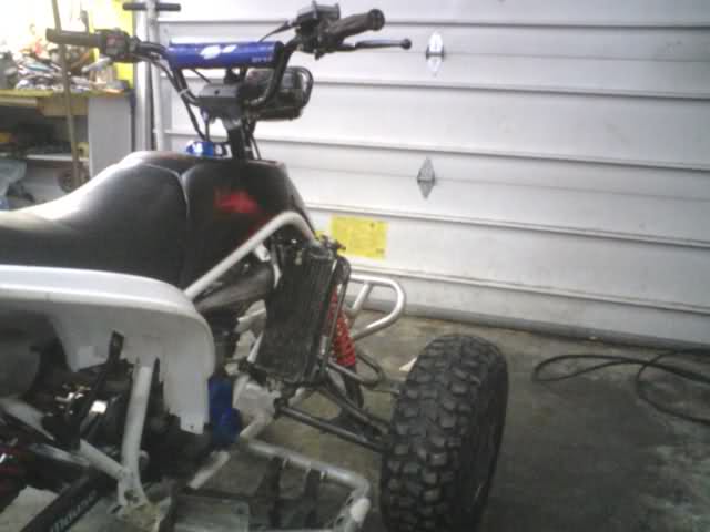

got the dt's single radiator mounted to the frame. using this rad for now may trade out for 250r's or majove one later.
both mounts for the rad are bolted to the fender mounts on the frame
