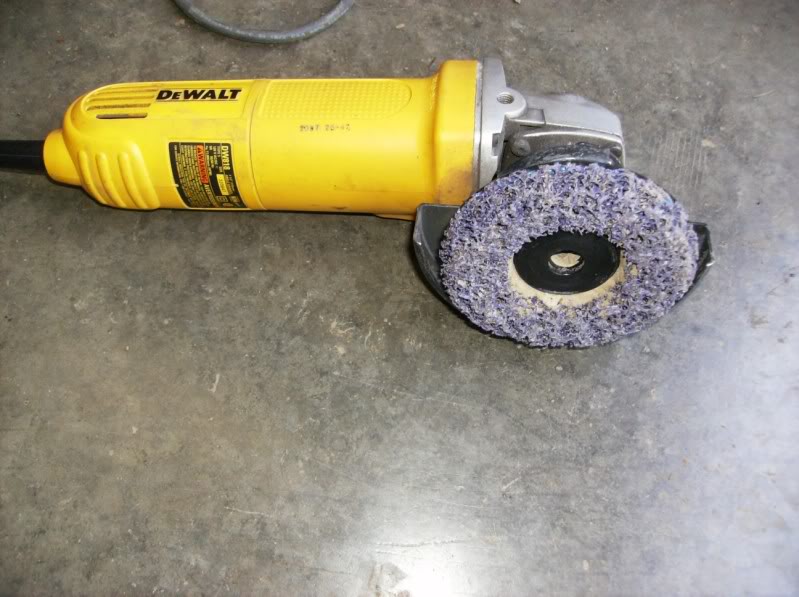

mr305 & yb200 definitely got it down for doing a fine job but here's a crude option. I bought one of these purple scotch pads that fits my side grinder for stripping paint and it didn't work very well so I tried it for shaping fenders and it worked great for me. Didn't load up & didn't melt the plastic like sandpaper sometimes does. I taped off rough lines, trimmed with tin snips & shaped it with the purple pad. You can polish it up with something fine if ya like. Made the shaping part quick & easy.
