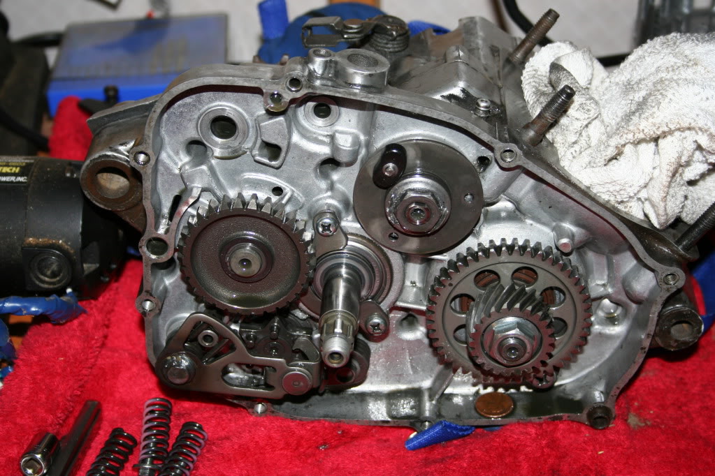

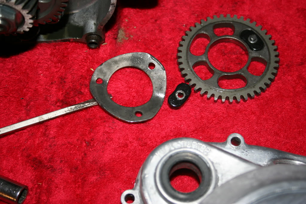

ok guys and gals the sprocket broke popped of the metal on top that held it in place im assuming i can just replace the sprocket. next when i put it back on is there a place it needs to be so it keeps balance, is it by chance in the manual that i didnt check yet.
thanks
are you talking about the gear that meshed with the primary drive gear behind the clutch basket? its more a gear than a sprocket. if so, yes the gear locates onto the shaft with a locator key and there is a dot on both the primary drive and balance shaft gears, they need to line up.

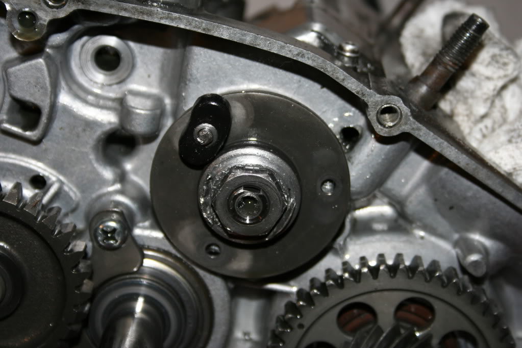

yea i know how they go together if it was never off by lining up the dots. but my counter balancer gear cog whatever the metal piece bust off its rivet so it was loose in the case, so how do i know if i put the balancer cog gear in so i can match those dots
ok i think a pic says it all maybe,
It will only go on one way it is keyed. And yes just get a new one or maybe someone has a spare- here is the part number- 37F-11530-00-00 BALANCER WEIGHT GEAR.
I've got a couple balancer gears. a new one for 45 shipped and a used one for 25 shipped. the used one is in good conditon. by the way buy a tusk flywheel/clutch holder to get that nut off. 15 bux at rockymountainatv.com the penny trick doesn't really work as you can see. lol you were in need of that gear anyway if the penny broke it.
i have the fly wheel holder was the angle and how the gear was busted couldnt get enough leverage and thought the penny might get me a little help and didnt, so now its got to go to my buddies shop cause i dont have a compressor, i did get the penny to work on one i did crank seals on though but it is when i ordered the tusk cause it didnt work well.
